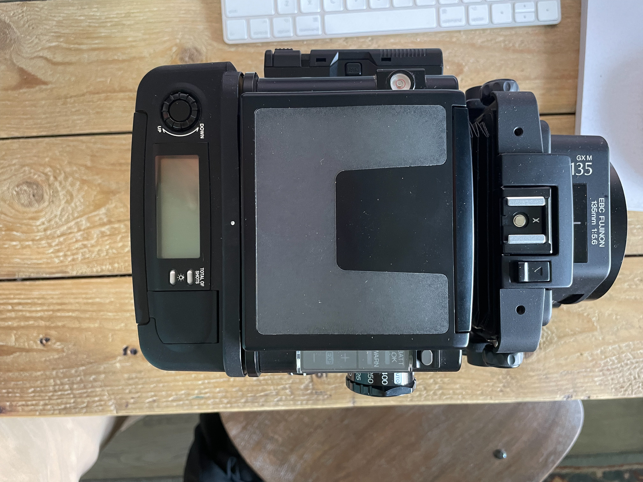

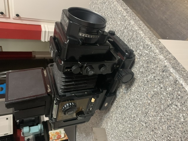

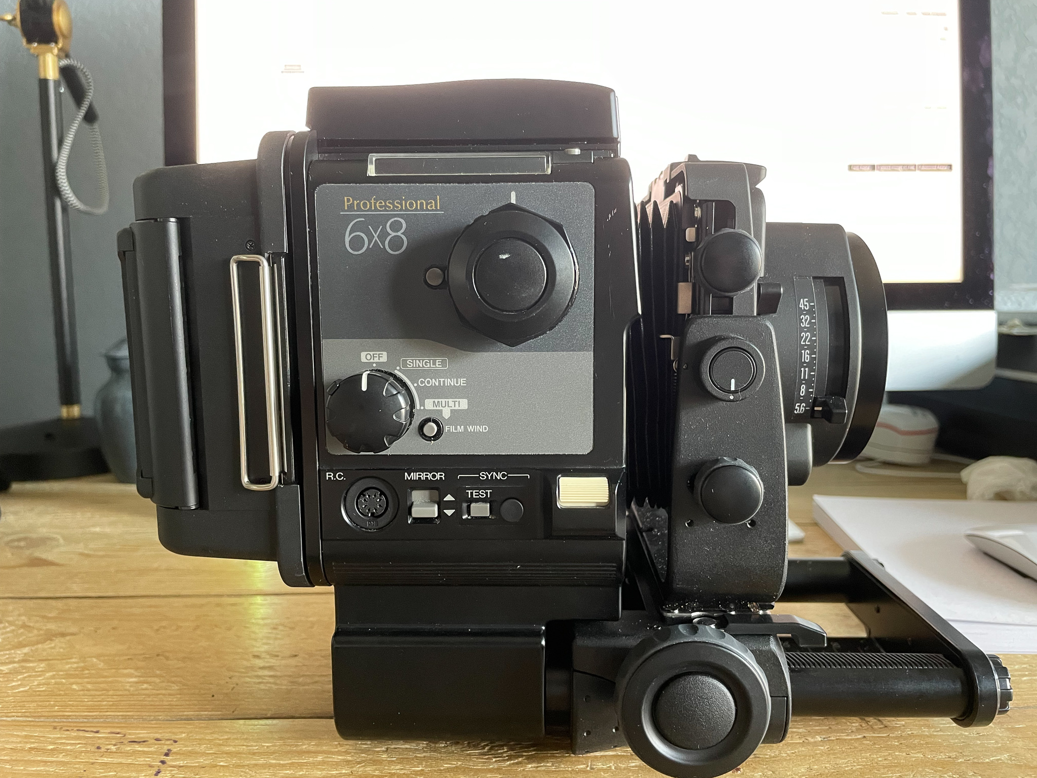

I recently received a Fuji GX 680 ( I think I have the II) and I am having trouble with it firing on single or continue. It fires on multi, and mirror lock up functions work, however it will not fire on single. Any help would be greatly appreciated.
I have uploaded some images. One is of the side of the camera; in hopes someone can tell me which one I have.
another image is of the Film back I think its the most modern of the bunch. And third is the battery pack.
I added the image of the film back because I wonder if I need the older versions.
I also added the battery pack image because I have read that sometimes the battery voltage can be a problem.
All batteries are new; slide is always out when trying to take image, tested out 6 different lenses... I am at a lost.
