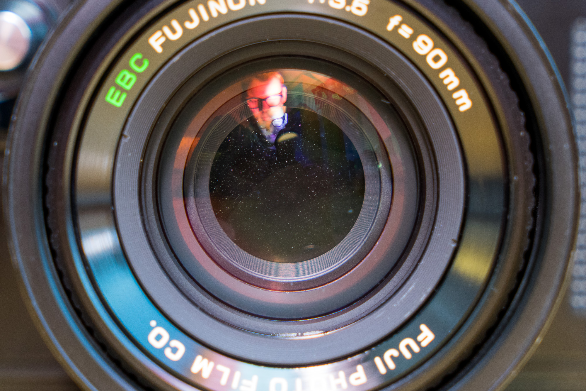

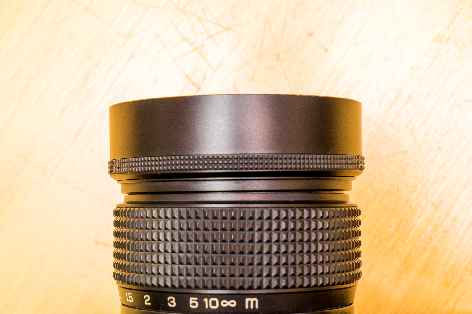

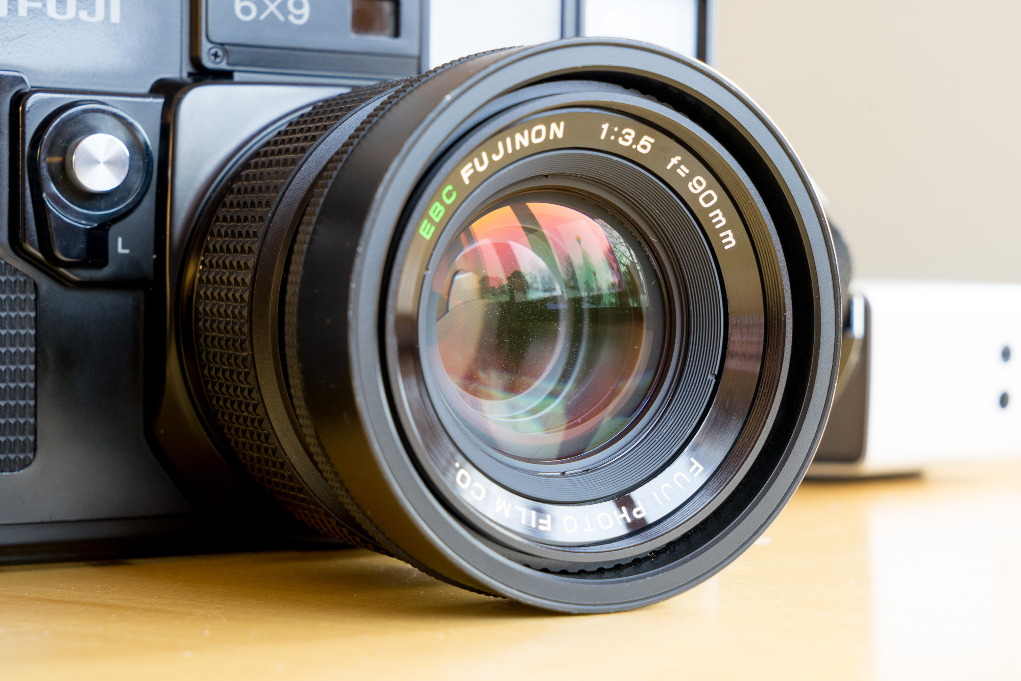

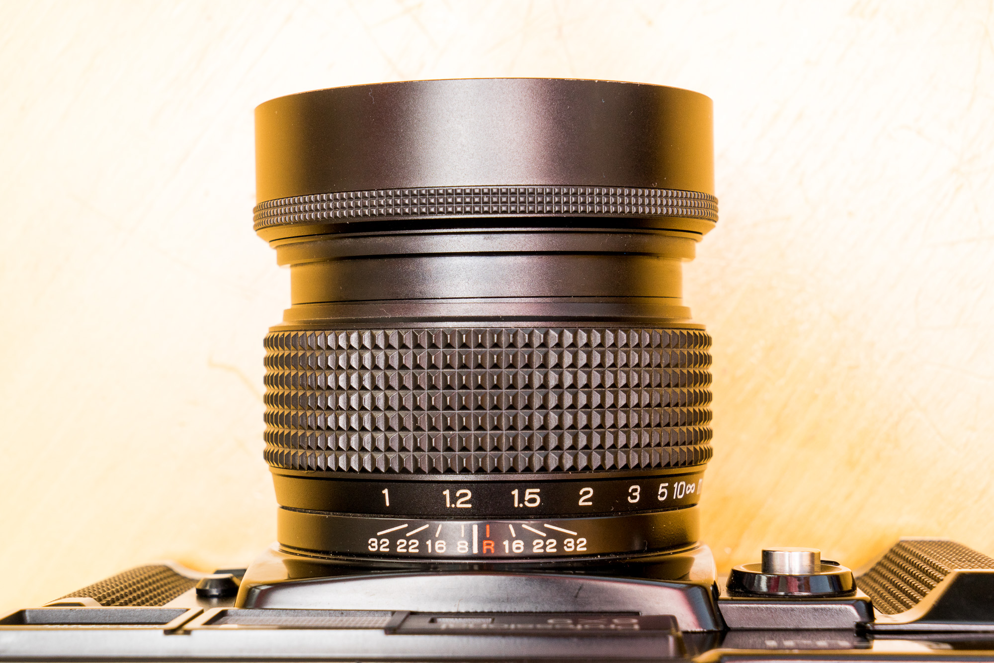

But as soon as I got it I noticed that the extending part of the lens is not completely straight. At least that's what it looks like. As if it has been dropped and got miss-aligned or something, but I can't see any serious damage on the outside of the camera. The lens barrel 'sticks out' about 1mm more on the right side. It still feels buttery smooth when focussing though. Incredibly smooth. But I'm worried it might give uneven sharpness across the frame. Anyone have one of these camera's and can see how your lens looks? How much will this possibly affect the sharpness?
The lens also has way more dust then I'd like and I wonder how this will affect the photographs. It almost looks like a layer of dust on 2 elements inside the lens.
I've added some images to show the issues. And since I paid both shipping and customs I'd rather not send it back (and pay more shipping) if not necessary.

Not to be a complete idiiot, but isn't that a sliding lens hood?
Huss
Feb 11, 2016
9,058
Hermosa Beach, CA
The sliding lens hood does not matter if it is slightly off. But that is way too much dust in the lens. Normally you only see dust under close scrutiny and that is ok. But to see so much of it so easily from a distance? That will create hazy low contrast shots, and may increase flare. I'd send it back.
Interestingly enough, I've had to send two GW690 cameras back to their Japanese ebay sellers, as they both were functionally deficient due to poor handling/storage (fungus and haze).
Bought one locally to me that was fine.
Good luck!

Below is a photo of the area in question from my GW690II. I have moved the hood out of the way to remove it from the equation. The area under discussion appears to be slightly different on my camera, but everything is parallel.

No, it's not the lenshood that is off. That would not matter at all. It is the lens itself.
That's right - the front part of the lens itself is skewed. My bet is that someone took it apart and that also explains the excessive dust.
Ahh, now I see it. And I agree with Theo. Someone took it apart in a dusty environment and was sloppy putting it back together.
If it was mine, I would have sent it back yesterday. This is not a rare camera to find one that has not been molestered.
