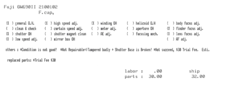

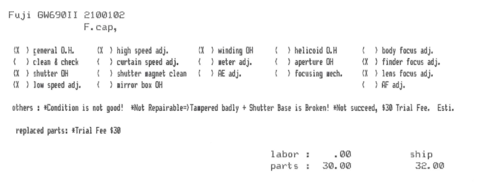

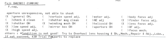

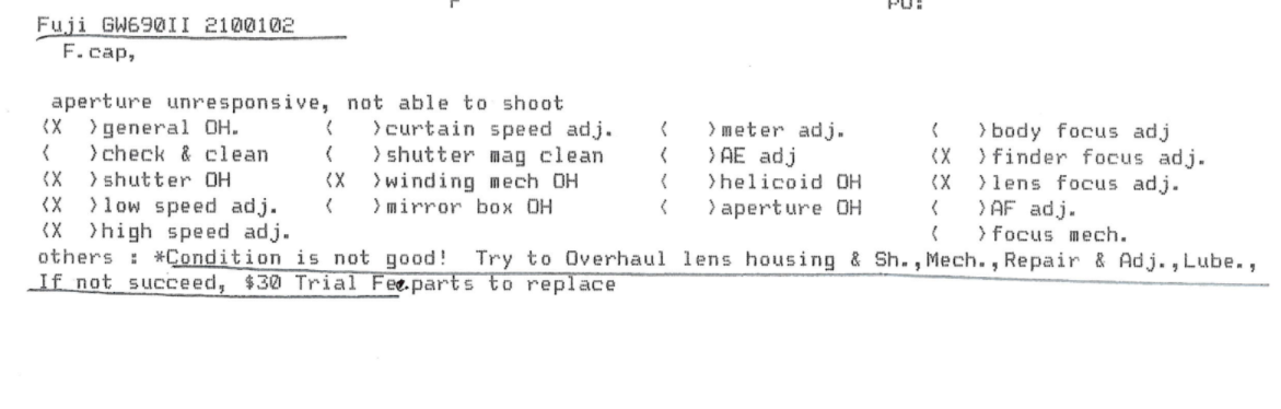

Hello,
I have a Fuji GW690ii and the aperture is unresponsive. The previous owner also mentioned that it would occasionally misfire. I sent the camera to Nippon Photo Clinic in NYC and they diagnosed it with a broken shutter base. They did not have parts to fix the camera and so were unable to make any repairs.
