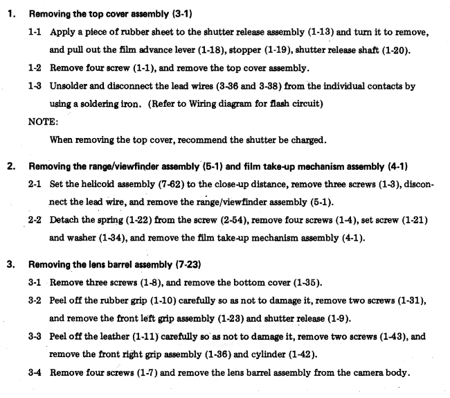

Once that black ring is off, it's fairly straightforward. They can be stubborn. I had to resort to using a needle-nosed Vise Grip plier cushioned with tape. Nobody seems to want to work on them because if something goes wrong, no spare parts are available anymore. Follow the repair manual; the shutter needs to be charged (cocked). But after the ring is screwed off, and once the tiny screws are removed allowing the whole top cover to be pulled off, the inner surfaces of the rangefinder elements are easily accessible to cleaning. The outer portions can be cleaned with Plexiglas polish without needing to remove anything. But the insides tend to get hazed over time and need cleaning per se.
macfred
Nov 6, 2014
3,839
Germany
From the Service Manual :
Bildschirmfoto 2021-10-26 um 10.13.07.png Bildschirmfoto 2021-10-26 um 10.13.42.png
