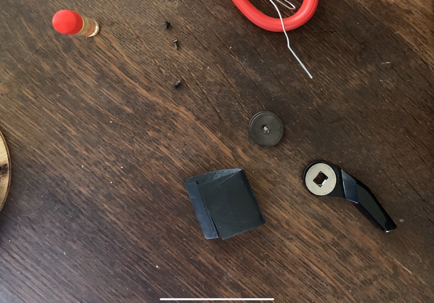

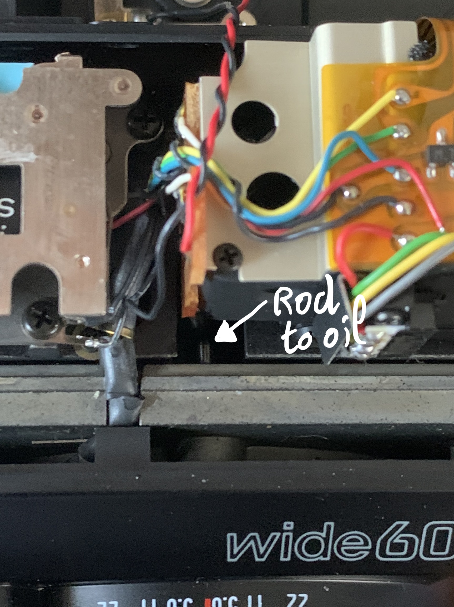

I actually had the same problem, and I managed to repair it myself. Pictures ahead.
You just need some (not even a drop) of good oil (I bought the 8000 Moebius, that worked like a charm and is used by watchmakers to lubricate mechanisms)
You can easily open the top plate by removing three screws (Philips 0) and unscrewing the top part of the advancing lever (I used a little piece of rubber to have a good grip, seen in the picture). Remove the top plate slowly as there are two wires connecting the hotshoe to the rest of the body. Let the top plate hang and there you’ll be able to see a little rod behind the lens, that moves when you turn the focus ring. That’s the one that you’ll have to oil. I used a paperclip for this, just bend it to make a little stick, put it in the oil, and then just touch the rod, move back and forth the focus ring to help the mechanism spread the oil and lubricate. Repeat, and you’ll see the rod will now follow perfectly the movement of the focus, no more delay, no more lag !
