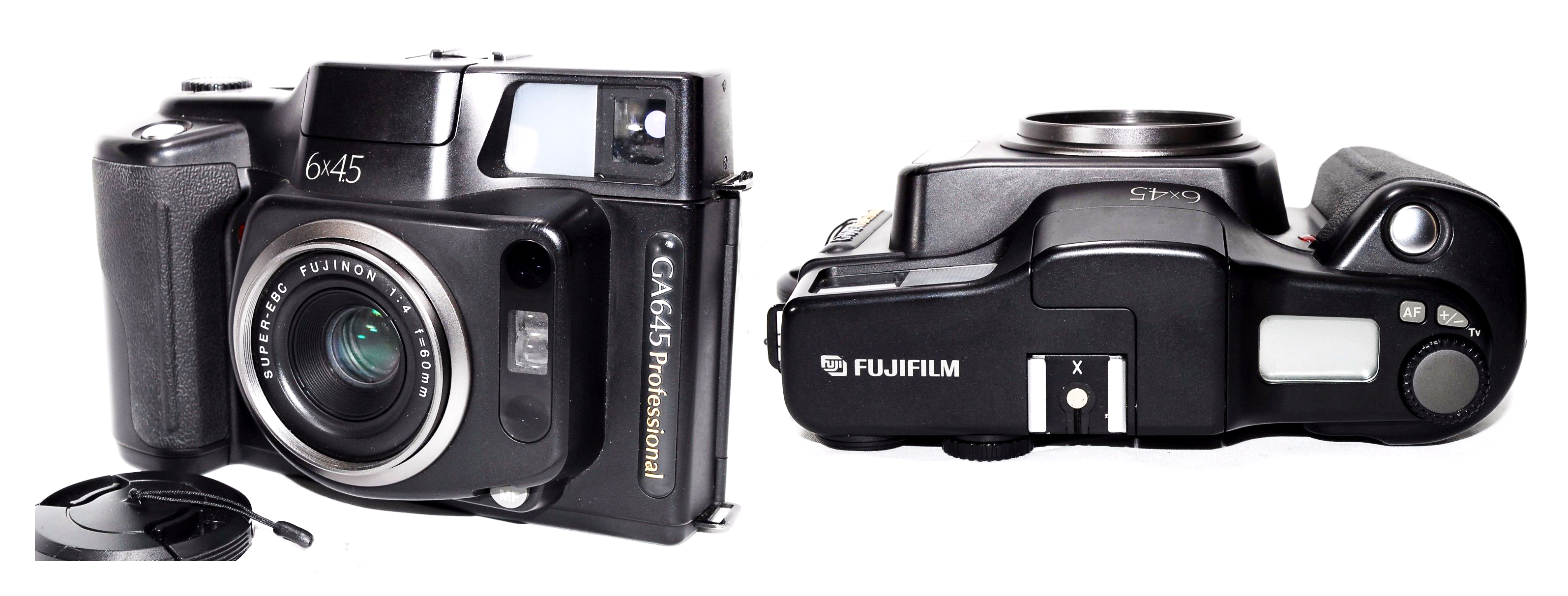

Any Fuji GA 645 ZI users out there?
Real user opinions appreciated.
Yes they are expensive and difficult to repair so are they worth the hassle?
