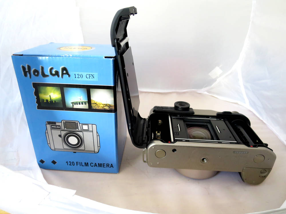

I, too, have had a Fuji GA645Zi for many years and it's a total blast to use! It's definitely one of those cameras that will be with me 'till the end. I can't even remember how long I've had it, but I've never had a single issue with it. I think the "ribbon cable issue" stems from folks flipping the back open and letting it "slam" against its max travel. I knew of the potential cable issue way back when I purchased it, so I very gently open the back and rest it easy fully open, load the film, then gently close the back. No idea if this helped me avoid the dreaded cable issue or I just got lucky with the camera I have, but my LCD is flawless.
Yeah, there are quite a few choices in lightweight MF carry cameras, but the Fuji 645's are just F-U-N!
That's an interesting hypothesis. It suggests an idea I may try. Perhaps mounting a small rubber stop near the hinge to limit door travel would help...

That's an interesting hypothesis. It suggests an idea I may try. Perhaps mounting a small rubber stop near the hing to limit door travel would help...
That's a good idea. I did this for more than 15 years
I have sold the camera as I prefer my GA645Wi which still delivers astonishing results.
