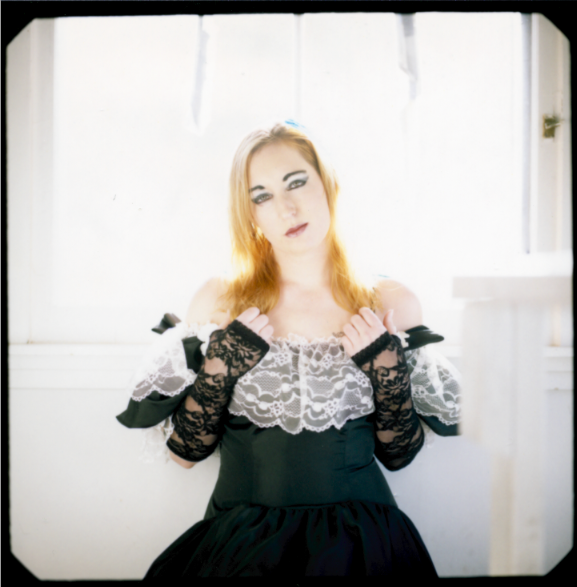

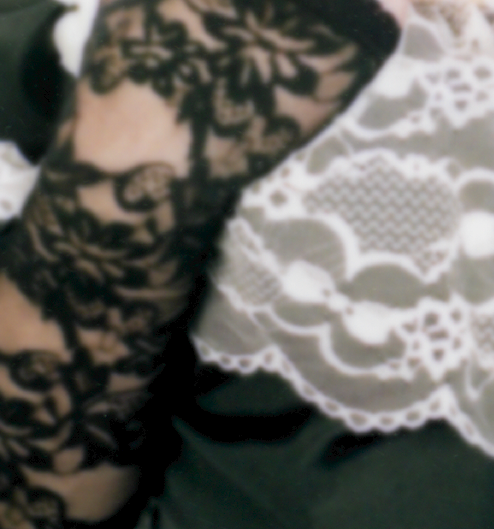

Here is a scan from a FP-100C print. I over exposed 1 stop on purpose, so the metering is correct. The first photo is the full frame, the second a 100% crop of the dress details. I just scanned at 300dpi on a V700, no sharpening, or colour correcting has been done. Details: 1/125 sec. ƒ/5.6 on a tripod.
As you can see on the 100% crop it seems blurry, not sure if its a back issue or not, but when I developed the Delta 100 & Portra negs from the shoot, the focus was spot on.
Hope the photos help.

the full frame looks a little soft too, is it sharper for real?
have you tried scanning at a larger size?

I tried both 1200 and 2400 optical dpi, same issues present there as in the 300dpi scan.

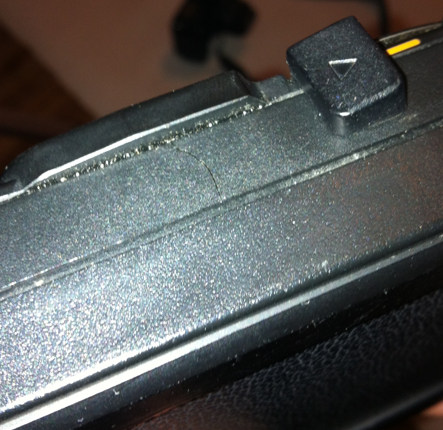

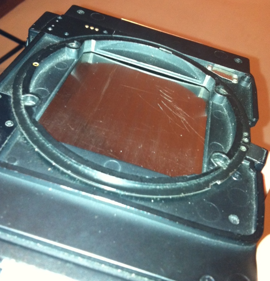

I took a better look at my back thinking it might be a back issue and I found 2 things I somehow missed in the year I had this back. There is a small crack in the clamshell hear the camera mount, I never had a light leak even when using fast film, so I'm not *that* concerned about it, but There is also a 2mm gap between the dark slide and the back body. Thinking it could be an alignment issue?
Could this factor into the film not being on the right plane to achieve a correct focus?

could then be that the film isn't sat at the right distance, so as Keith says, better get out some tracing paper and test it.
the way I test mine is that I cut a hole in an old film cartridge and put a bit of tracing paper where the film would normally be sandwiched in the pack.
