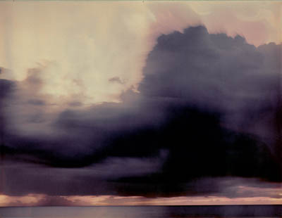

I did it a few times years ago. It was fun and the results were definitely different. if you have some negs laying around, what do you have to lose? Little tape, little bleach and you are there. This is a terrible scan since I just tossed it on the scanner so the horizon is all wiggly, but it will give you an idea. Probably a terrible idea, but an idea nonetheless....

thanks for the photos and info. I'm just trying to imagine a workflow that generates a bunch of sticky negs. Are they still light sensitive and where did all the silver go?

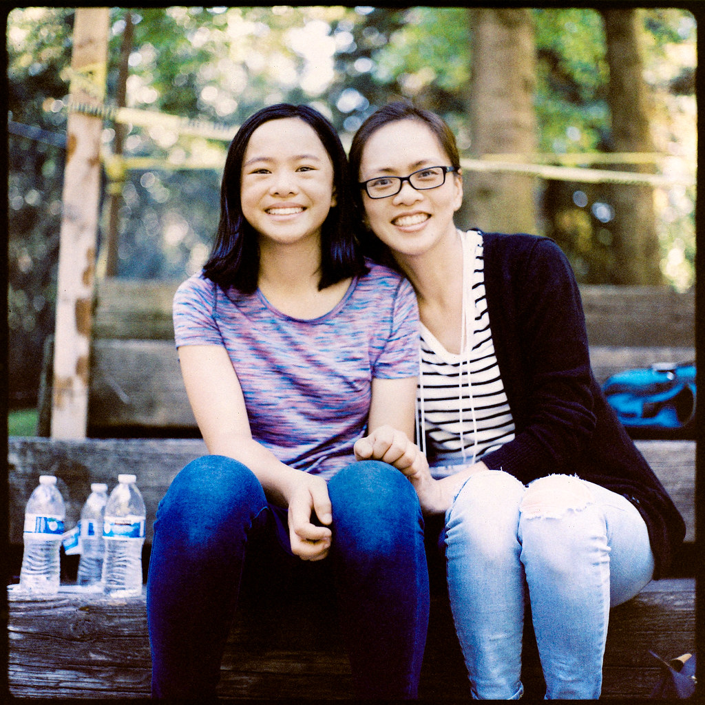

It was color. FP3000b can be scanned directly, you don’t need to bleach it.
