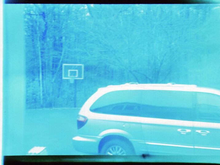

I acquired an ancient camera by most standards which says KODAK in fancy lettering and uses 122 postcard roll film. As I didn't happen to have any I stuck some fuji crystal archive color paper cut down to 4x5 inches. It definitely works and I've figured the ASA of the paper to be ~~8.
I now have a problem because all my negatives have a reddish to magenta cast and all my prints are coming out cyan until I cancel that out and am left with an almost monotone print that looks ugly. I want to filter in camera so to cancel out a cyan print cast, I would use a red filter? Red filters out cyan light...but if it increases red percentage it would increase the cyan in the negative, which you increase the magenta and yellow in the final print evening it all out, in theory. For magenta I would need green? I need some help because every time I work through the logic I get a different answer:confused:.
Has anyone had experience with exposing this in camera? I've just always gotten my base values and printed, though come to think of it it's always been a reddish light when the values are set. The paper is blue to cyan in color before processing...
I understand reciprocity can be an issue when exposing at "fast" speeds like 1/25 of a second. Since the camera has 25,50,100 and bulb I am going to end up shooting 1/25 a lot of the time so I don't have to go beyond 2 seconds to where I can accurately time the exposures off hand. Can anyone fill me in the reciprocity? I heard that it's fine between 3-30 seconds, but what will happen? Specifically color shift.
Attached is an inverted neg scan. Notice there is red in the tail light.

Paper for printing color negatives is balanced for tungsten plus the orange mask that color negs have plus a standard filter pack that would be adjusted for differences between films and lighting conditions of different scenes. That's probably going to add up to something like two 85B filters plus some yellow and magenta to fine tune it.

It's basically tungsten balanced + whatever the starting filter pack is (about 50R).

The actual ISO is closer to 100 in the blue, 50 in green and 25 in red, but due to all the filtration needed, who knows what the speed will end up.
Start with a heavy orange or red filter used to convert tungsten film to daylight use. Then go from there.

I'll bet if you shot under tungsten light, the speed would be up.
But, it might just be Fuji paper. All of my work was with Endura.

I would suggest to go with the orange filter (designed for using tungsten film in daylight) as PE suggested above or tungsten light (also suggested by PE - he's almost always right, you know :wink: )
On top of that, I'd probably start with 50M + 50Y (normal starting filter pack) and go from there.

Try on camera filtration of 80 yellow and 65 magenta. If ISO 8 worked w/o filtration try an ei of 1 or .5 with the filtration I mention (65magenta `2 stops and O believe 0 yellow would be about 1 stop). If you shoot under tungstun light lower the filtration by 15 magenta and 30 yellow.
