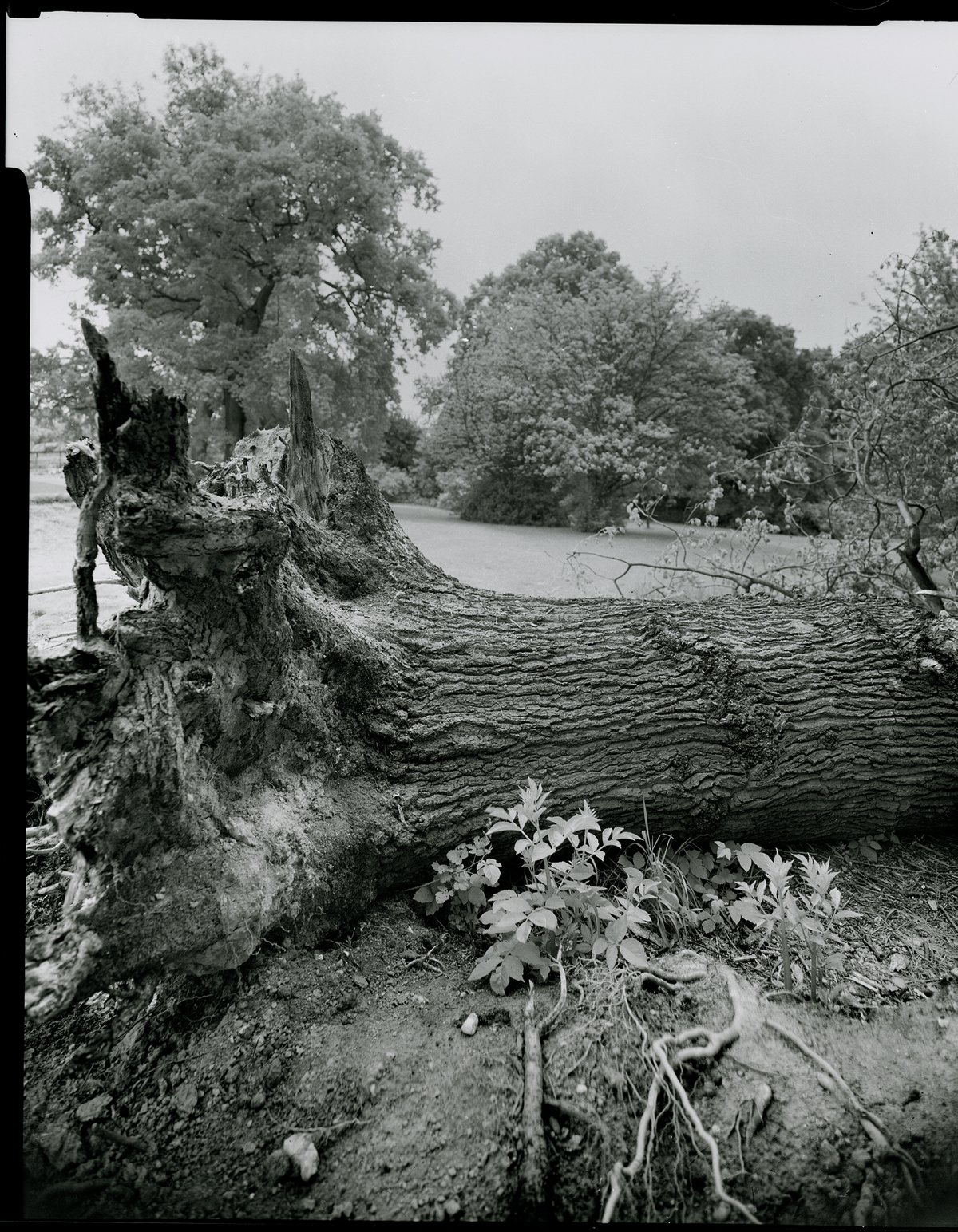

I thought this 17 year old thread needed an update.
It doesn't seem like there are many users of this unusual salt containing developer specifically engineered for large format sheet film using 'flash development' times of 2 -3 minutes.
The principle of flash development (from toe to curve), reduces the bromide drag build up and presents a more consistent streak free development of the sheet ... perhaps at the expense of the tonal scale. I'm still on the fence about this idea.
In any case I think the developer is no longer available outside of Japan. This is an example shot on a Silvestri Hermes 5x4 inch architectural camera, Schneider Super Angulon 75/5.6 lens on Rollei Infrared Film developed in Fuji Artdol 1:3 dilution for 3 minutes.
I've not submitted the times to the Digital Truth site since there isn't any demand for this developer now however in the case a photographer is interested, this thread pops up in the ecofriendly www.ecosia.org websearch which plants trees to make up for the fallen ones.
Image: Fallen Tree, Crowhurst, Kent (England)
