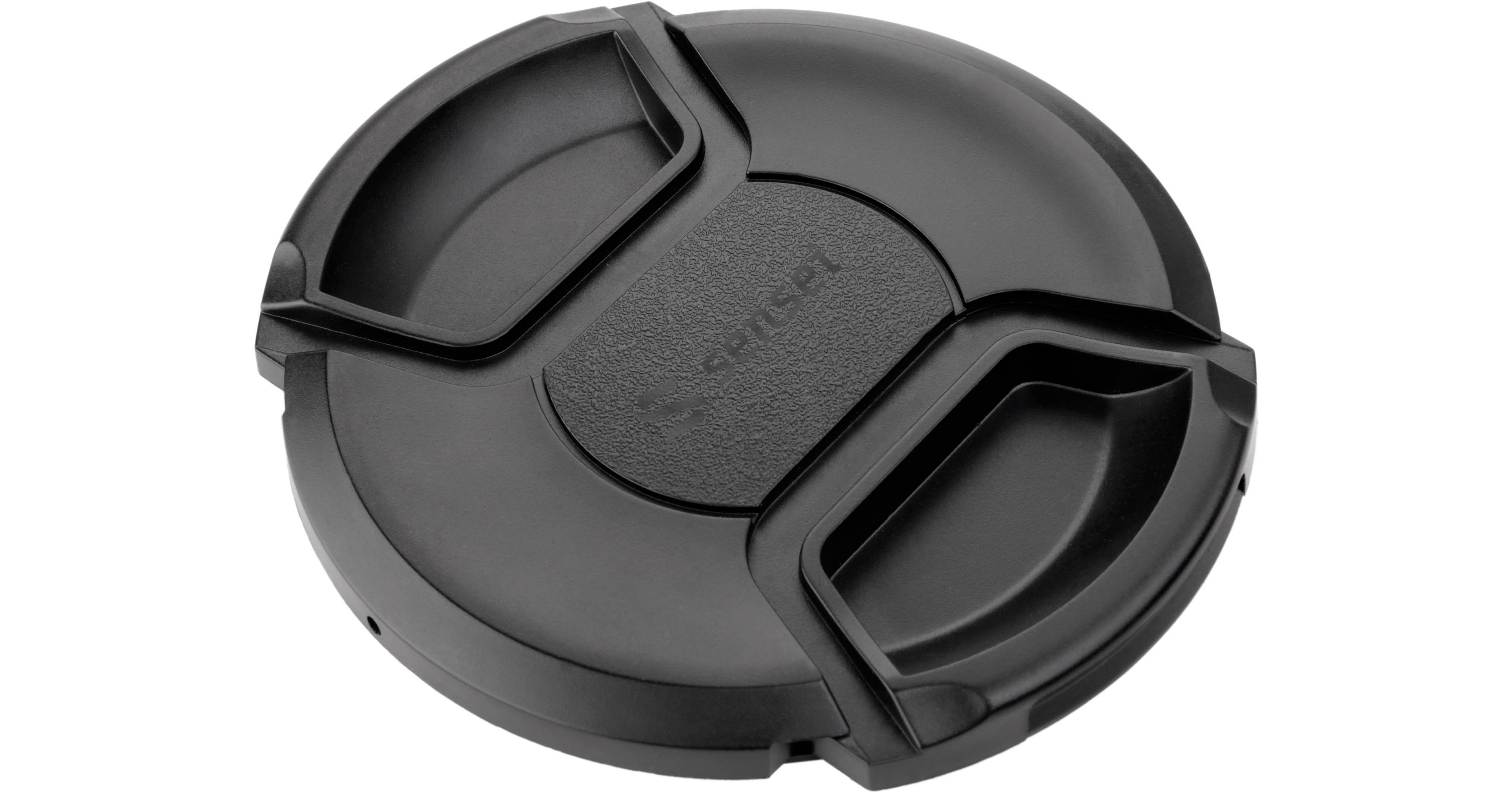

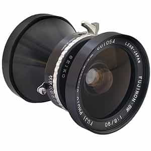

I recently purchased a Fuji 90mm f/8 Fujinon SW Lens (216mm Image Circle) in Seiko B Shutter (35MT) that was rated as bargain on KEH. The lens arrived and is in really nice condition. I have two questions, if anyone can help me out. The filter thread size is not listed on the lens name plate. Does anyone have this lens that could provide that information? I need to source a lens cap for the front. If possible the rear as well. Also, I usually shield my LF lenses with a dark slide however, should I source a lens hood for this lens? Any inputs, greatly appreciated. Thanks.

Last time I needed Fuji lenscaps I got them from KEH.

it seems your lens is listed here with a 67mm diameter. Amazon sells Hama rubber hoods in 67mm, you can fold them as wide or narrow as you need.

I have that lens, the OD of the rear element is 64mm.
The OD of the front element is 70mm.
I have press fit covers for both, with the front being a plastic Nikon unit and the rear being a quite old Wollensak Rochester metal unit with some soft velour type material inside.
I use my film darkslide for lens shading for everything from 65mm through to 250mm with nary an issue. A compendium lens shade has been on my wish list for around the last 20 years, somehow I think one of them has missed my boat.

I have a 67mm center-pinch (courtesy of Breakthrough Photography) on the front of mine, and a 65mm slip-on (Kaiser) on the back.

I have the SW S version of the lens. Threads are 67mm. I use the collapsible Hama rubber lens hood collapsed to the wide angle position. No vignetting from the hood except a touch with extreme front rise. I think the lens has a bit of flare and you would benefit from a hood.
