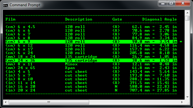

...what is the 35mm equivalent for the 90mm and 65mm standard lenses?
For a 90mm lens on a 6x9 format camera the equivalent 135 format focal length lens is 38.6mm:

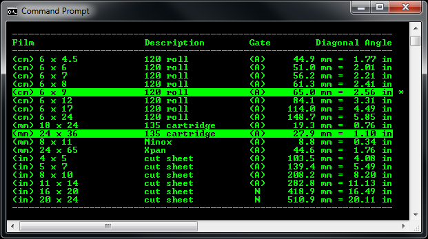

And for a 65mm lens on a 6x9 format camera the equivalent 135 format focal length lens is 27.9mm:

From everything I've heard about their reliability, they're quite good cameras. Don't have a specific recommendation for repair people. The 90mm would be the equivalent of a 45-50mm on 35mm film. The 65 would be then more like a 28-30mm.
IOW they have a choice of slightly too wide and slightly too long. :wink:
I'd want something equivalent to about a 35mm if I could only have one.
EDIT: Should have kept reading for Ken's comment. The 90 would be close enough I think.

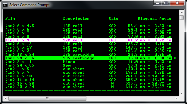

So then, working in the other direction, a 35mm lens in 135 format would scale up to an 81.7mm lens in 6x9 format:

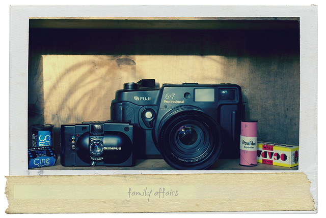

Fuji Medium Format Rangefinders
by Narsuitus, on Flickr
When Fuji announced they were going to stop making and supporting the 6x9 and 6x7 medium format rangefinders I owned, I put the following two repair sites in my files. These two sites were known to do a good job repairing Fuji rangefinders.
Trying to decide between 6x7 and 6x9, now that I see them next to each other I can understand why you HAVE TO HAVE BOTH.
Dang, those are some sexy cameras.

Ken that's cool tool you got there, what's that? and what's the GATE?
The GATE column indicates whether the film gate dimension used in the calculation for that line is a Nominal value (60x60mm for a 6x6 format), or the true Actual value (56x56mm for 6x6). That tiny difference can make a substantial difference in the results.
Another example might be 4x5 sheet film, which is not actually 4-inches by 5-inches in size to begin with, and is even less once the actual image area is masked off by the film holder.

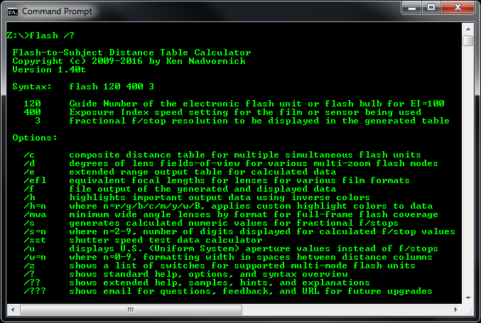

The tool itself is a personal creation by and for myself. It's been around since 2009 and was originally designed to create flash-to-subject distance tables that could be printed and stuck on my various cameras. Back then I had an old no-name electronic flash that had lost its calculator dial and I needed a replacement table. Later when I began using flashbulbs on a Graflex, it was perfect for those as well.
Since that time the tool has turned into sort of a Swiss Army knife of strange features, each of which I needed at some point in time and could not find another source for answers, and so got tossed into the eclectic mix.
Here's the main help screen for a better idea of what it (currently) does. It's an old-school Windows command line utility because it was originally intended just for me to get quick answers to my own questions. Although as such it does seem like a philosophically complementary fit for old-school analog photography in general...
The earlier use in this thread for converting 6x9 focal lengths to equivalent 135 focal lengths was achieved by invoking the /efl option shown above, together with the /h option for data highlighting.
I had an earlier downloadable version of this utility in the Articles section of the old APUG, just for anyone who might like to play around with it. I think a small handful of members here might have looked at it. But there was quite a bit more interest from outside of APUG, since the articles themselves showed up in Google searches.
The above screen shows a much newer version than that older one. I was going to wait for Sean to get around to reworking the new Resources section (the Articles replacement forum), then upload this newer version there.

That's a really cool tool Ken. I probably would have downloaded the old one had I known about it. I guess I need to explore the rest of APUG other than just the forums some! Can you let us know when you have the new one has been uploaded and is available?
