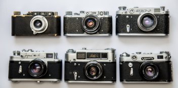

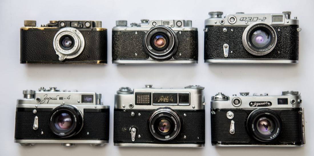

While there is a lot to be said for SLRs, I love my Barnacks. After running film through Zorki (1), 4, 6, Canon IIS, IVSB2, and a Leica IIIf, I have to admit that my favorites are my Leica IIIf and my Zorki (1).
Many people think that rangefinders are 'slow', yet I find my Leica to be very fast to compose, focus and shoot. I love the clockwork type mechanism of both the Zorki and Leica and the wonderful sound of the Leica shutter.
I never could decide the answer to the OP's question so I kept all of them (attachment).
Top left is one of the first large production batch of Leica II (it has a newer lens fitted).

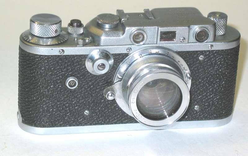

Now, to wrap up the FED NKVD educational part, here's a FED from 1938 with slow speeds front dial - just like Leica III, including the top speed 1/1000.
attachment.php
It is a FED B (pretty rare) fitted with a 2.0/50mm FED lens. Please note the added synchro flash.
