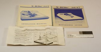

The X-Rite 361T is a B/W Transmission densitometer designed to meet the quality control needs of the Graphic Arts industry. It is used to determine the contrast ranges of modern large format film.
To my knowledge it is the only available densitometer to offer both UV and ortho modes, so it is great when working with alternative processes, and is the standard densitometer for silver gelatin printing to get those film speeds and printing times just right.
None of the units I saw on eBay mention the calibration strip. The X-Rite 5 step calibration strip. Serial # 003579 or P/N 361-68. It is included with this unit.
That is important because the X-Rite 5 step calibration strip costs $95 from X-Rite or roughly ⅓ the price asked for the unit and is needed for calibration.
http://www.xrite.com/product_overvie...on=Accessories
The unit is used to adjust exposure for printing. The UV mode measures film base fog. New price $3410 from X-Rite
http://www.xrite.com/documents/manua..._Manual_en.pdf
For more detail, here is an article on the Unblinking Eye about Bob Herbst’s use of The X-Rite 361T to determine proper exposure of pyro negatives for platinum printing. http://www.unblinkingeye.com/Articles/Densi/densi.html
This unit was setup in my darkroom by platinum printer Peter Spangenberg. It is working today as you can see in the photo.
Included with the unit: The “Operation Manual”, “Instrument Registration Form”, “Reference Guide” and “Lamp Replacement/ Alignment Instructions”, all for the X-Rite 361T Densitometer.
Price $300 to me plus postage and insurance from Bath, OH 44210 USA
Payment by Paypal as a gift. Paypal as a purchase plus 3%, or Cashier’s check.
No postal money order please. The Bath, OH Post Office is so small it took them five days to accumulate $350 the last time someone sent me a money order.
John Powers: 565 posts LF Forum since Apr 2001, JP80874 on Apug 3,267 posts since Jul 2004, JP80874 on eBay 851 transactions, 100% positive feedback.
If you have any questions please ask. Thank you for looking.

Thank you all. The X-Rite 361T is sold pending payment.
