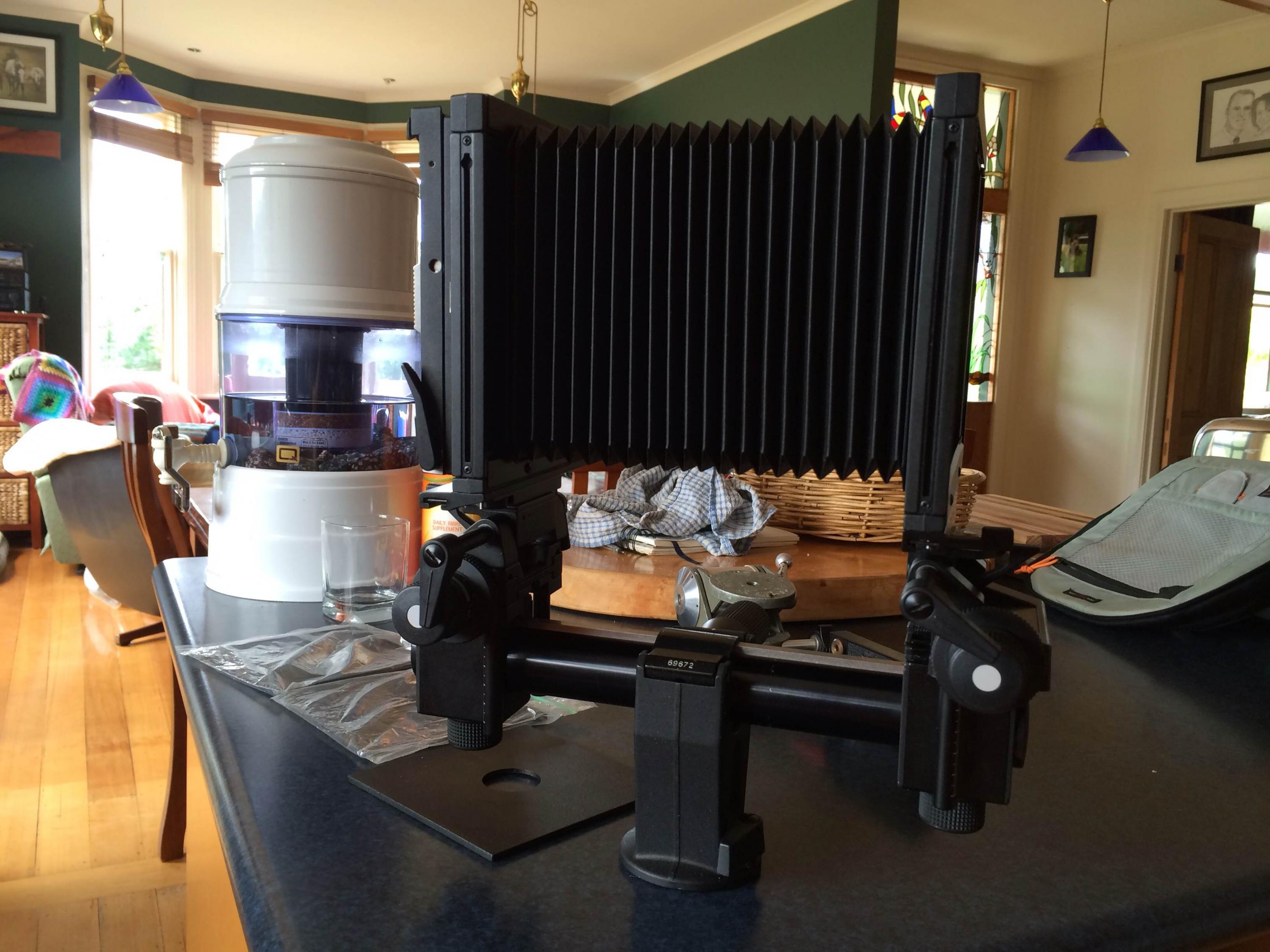

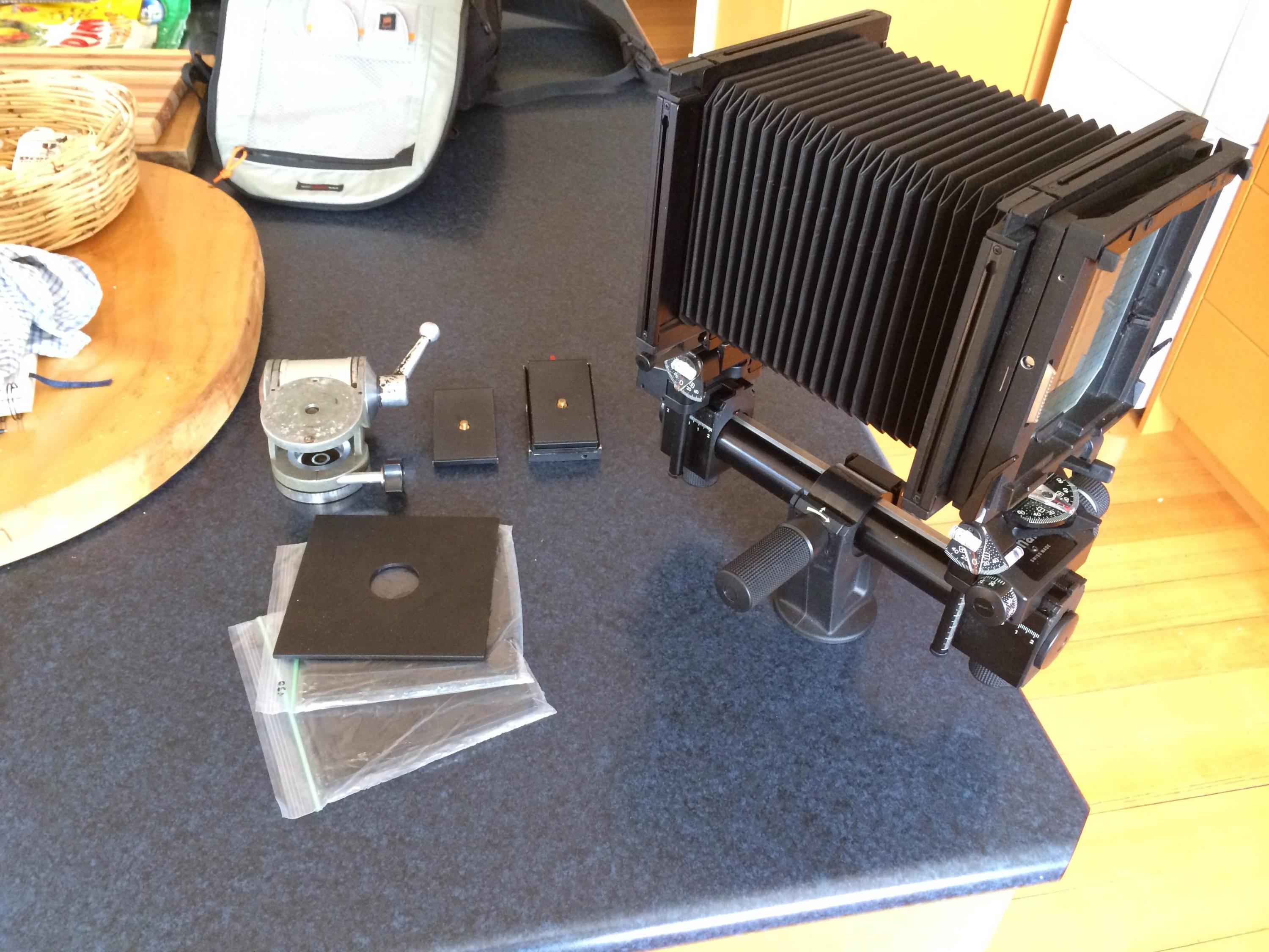

I had this listed before as just the camera but am relisting it with some extras.
The lens boards are 2x Copal #0 and 1x Copal #1

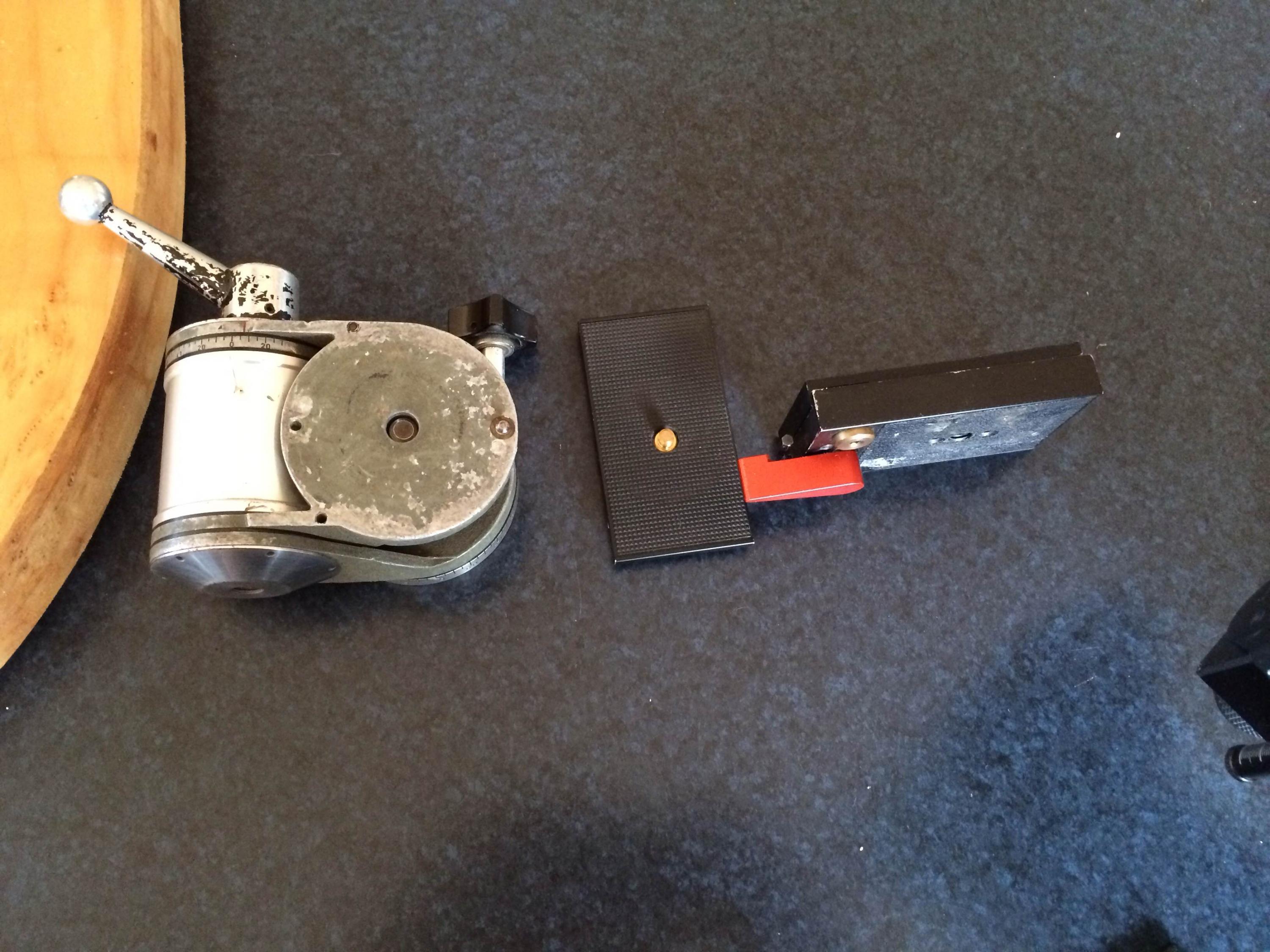

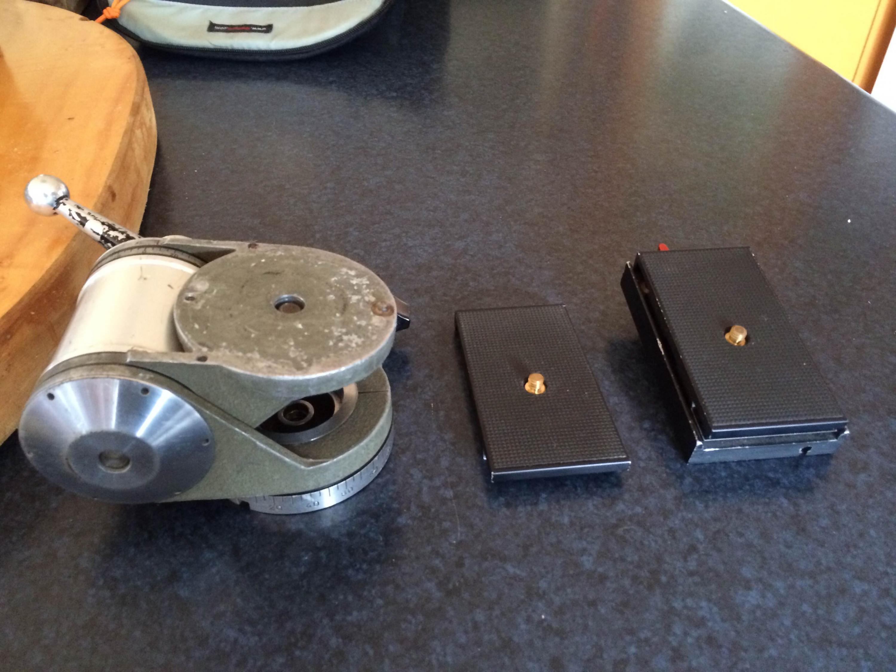

The Sinar tripod head is old and well used but works perfectly and is incredibly solid and robust. It cost me $256 AUD.
The Linhof quick release mount is also handy and comes with an extra plate. It came with my toyo as a package deal and I have no use for it.
I bought the lens boards from B&H Photo so they're of really good quality. (they weren't cheap!)

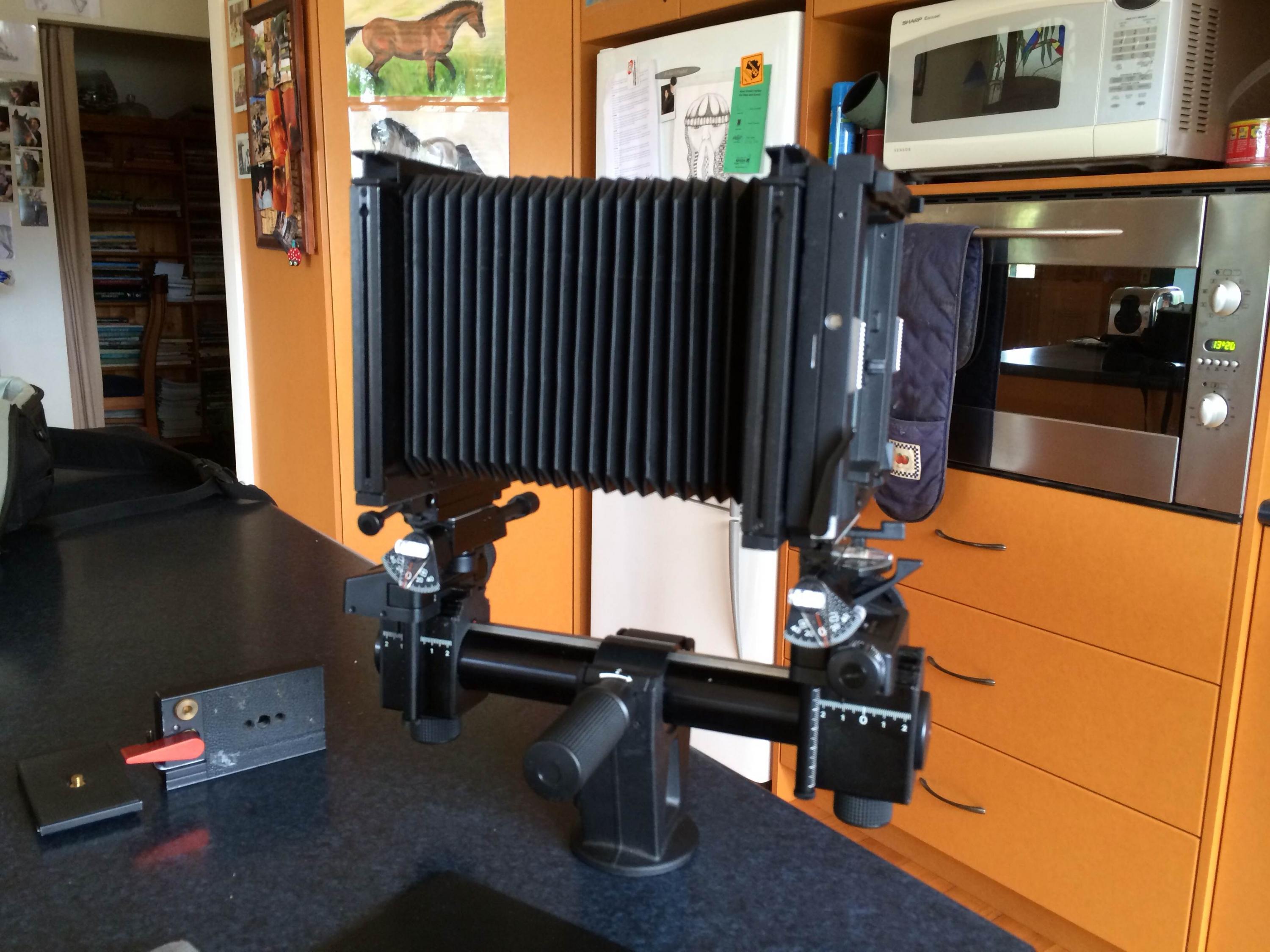

The camera works perfectly and shows only very slight signs of use. I'd give it a 9.5/10. The spirit levels are all in tact and the gears all move freely and smoothly.
I am located in Australia. Buyer pays shipping. Paypal.
I am asking $900 AUD.
