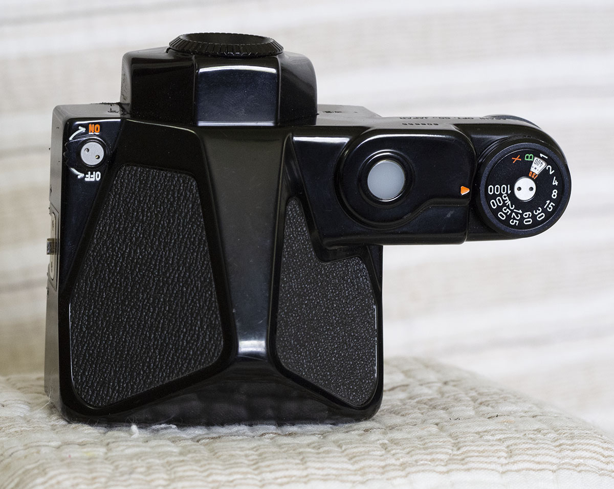

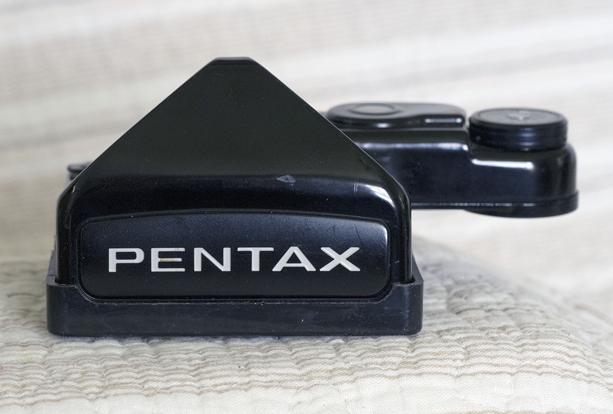

Pentax 67 metered prism finder in excellent condition. The meter works, but only in manual metering mode, i.e. you switch the lens to manual and meter with the lens stopped down. This is a known failure mode for these finders - there are two circuits inside, and the "auto" setting circuit is prone to failure. Once you get used to it, you don't really notice, as manual mode works perfectly well. Includes base cap.
$100 net to me - includes USPS Priority Mail shipping.

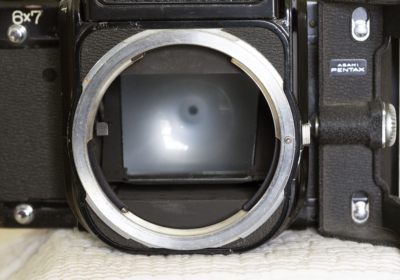

"The TTL prism has two sides to the meter circuit. One is in the "AUTO" mode, and it takes into account the Aperture (Av) position and the Shutter (Sv) position, along with the light sensor. In the "MAN" mode, the Av input is ignored and the meter reading depends only on the Sv input and the light meter."
By the way, the "auto" vs "man" switching is sensed by the meter from the pressing of a small pin in the lens mount. You can see it on the right side of the mount in the attached picture.
