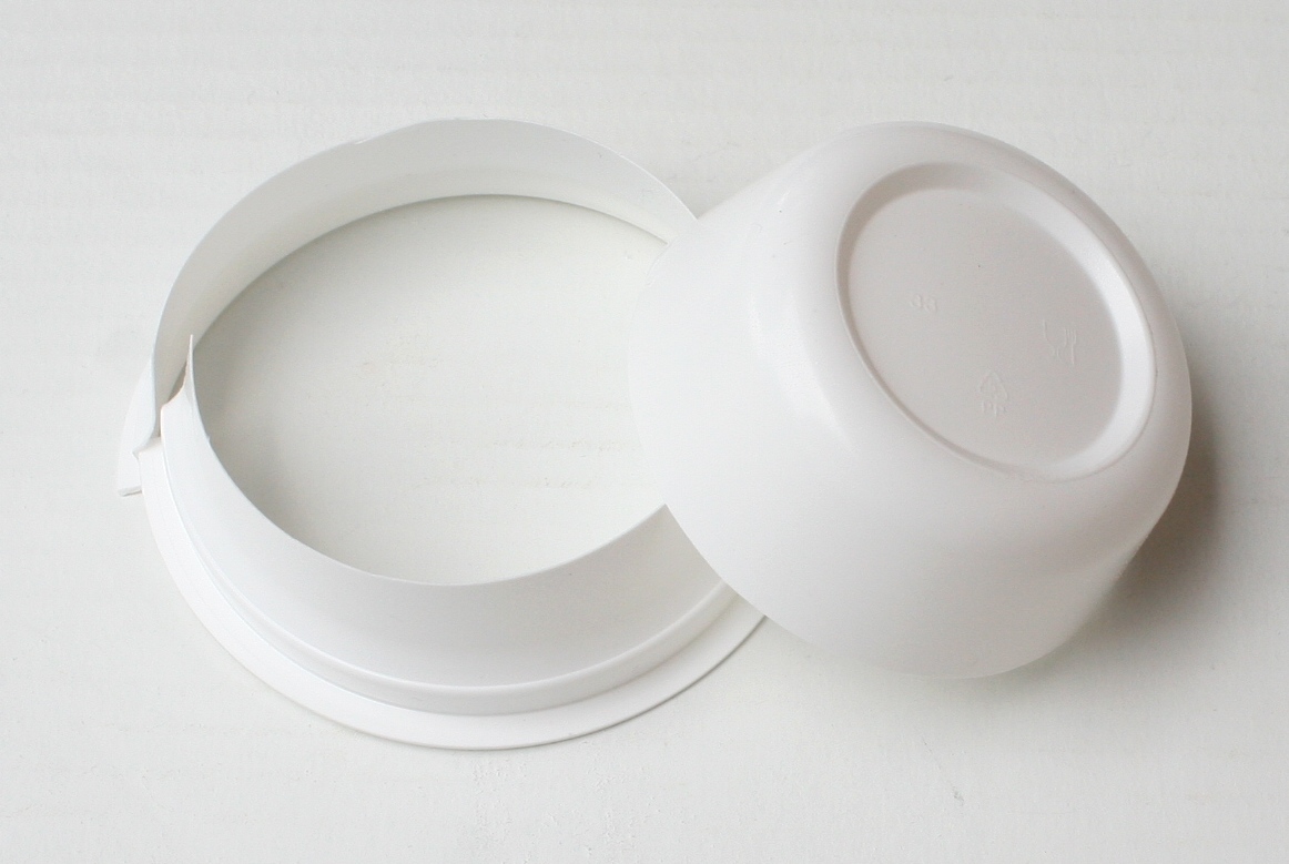

1. Eat a carton of yogurt or if you have lactose intolerance or milk allergies in your family, have your least favorite child eat it. Yoplait Greek yogurt is a good one. When you're finished, wash and dry the plastic container well. You can also use a styrofoam coffee cup (the kind you get at hospital waiting rooms), but the yogurt container will be much more long-lasting and I think bringing it closer to the lens helps your reading be more correct.
2. Using scissors or a knife, carefully remove the plastic wrapping from the white carton. Once you get it started, it should be pretty easy to peel off. When you've done that, use scissors (or a knife) to carefully cut about an inch off the top of that carton, leaving you with a smaller and more shallow carton as in image 1 below.

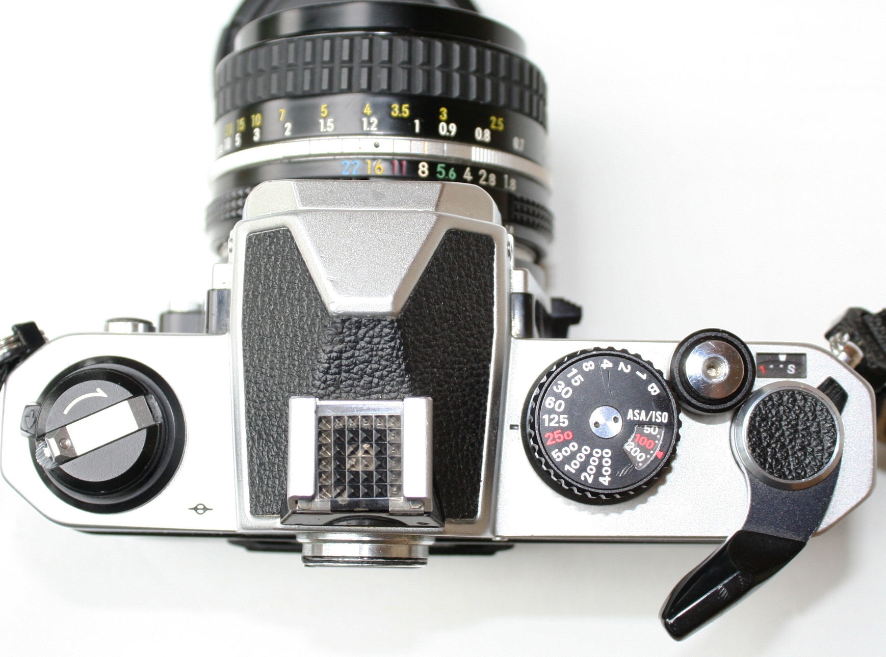

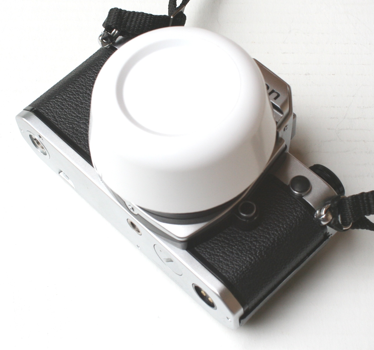

3. This smaller carton should fit over a typical 50mm (or 35mm or any similar) lens. I would not use a zoom lens if I were you. You can see this in image 2 below. The end should fit nicely against the lens end.
4. Set your camera as I've done in image 3 below. ASA set to 125 (or 100 if 125 isn't a possible choice for you). Shutter speed to 1/125. Aperture set to 16 (or a bit past 16 if you must use ASA 100 speed). Now with the yogurt container held over your lens, go outside on a cloudless day and point your lens right at the sun. Your meter should see this scheme as ideal. If your meter reads a bit + or - in this scenario, you'll at least know what the right correction factor is...example 1/4 stop, 1/2 stop, etc.
