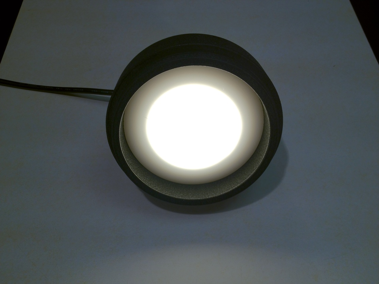

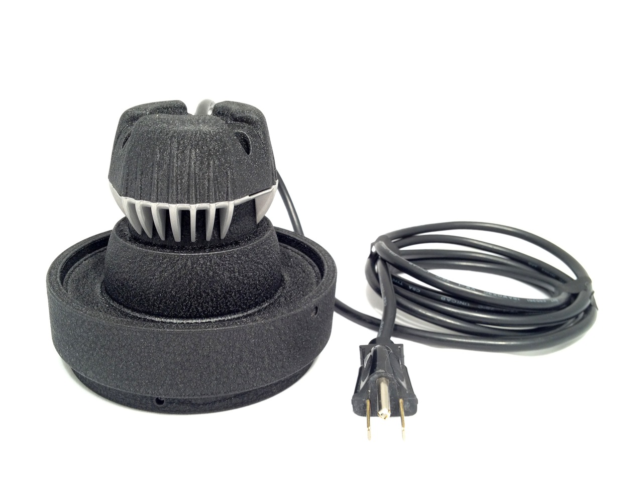

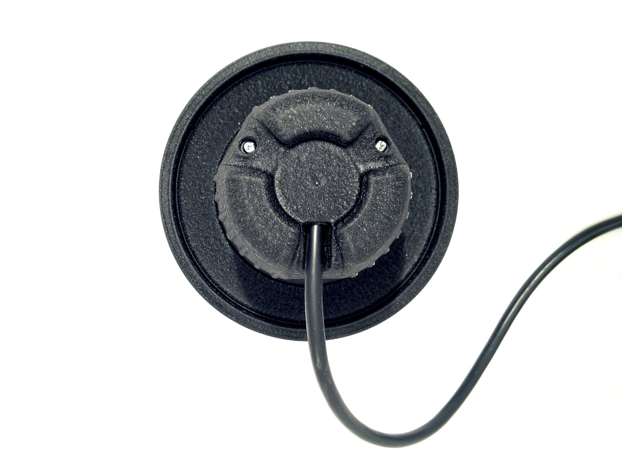

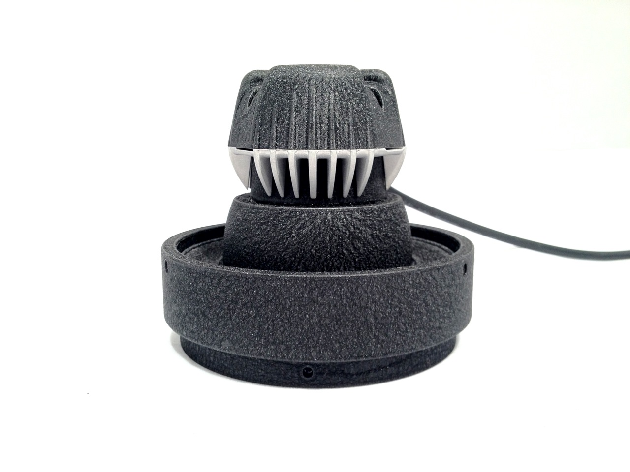

This is a brand new LED replacement lamp house for the Omega D2, D3, D5 and D6 condenser enlargers. It replaces only the existing lamp house so you keep the condensers and the ability to use above-the-lens VC filters. The primary advantage is the total lack of infrared radiation, so the negative will not heat up, no matter how long the exposure. This prevents shifting and popping of the negative which can ruin focus. Also, since the light comes only from the center of the lens there is much less stray light than with a bulb which tends to reflect a lot of light off the black lamp housing. The end result is that prints made with this product are very, very sharp. Glass negative carriers are not needed for most negatives. The unit is a real pleasure to use.
Build quality and uniformity of illumination, both spatially and temporally, are superb. Ilford VC filters work as expected with this unit. Exposure times are similar to those of a 150W bulb. Uses 110VAC, 9.5W North American standard power.
Asking US$150.00 plus shipping however you want.

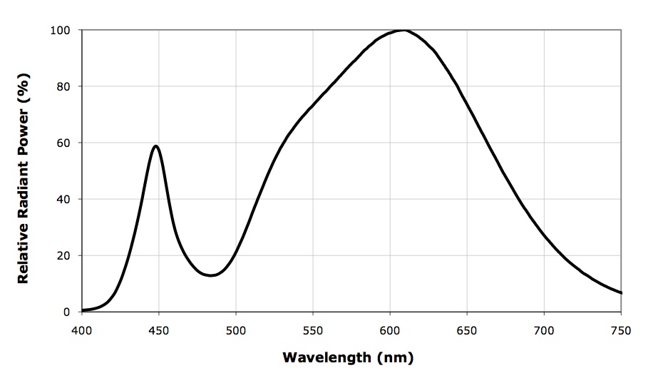

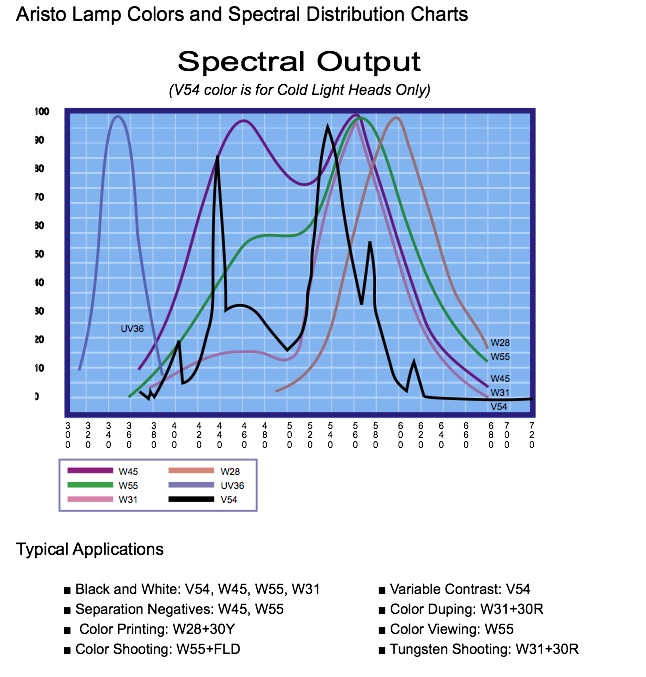

I wonder if it will be possible to filter this LED source for color with color printing filters? Not sure if the spectrum is suitable or not, but eventually I'll try that. If it doesn't work, changing back to my tungsten source for color takes about 30 seconds.
Thanks for the kind words regarding this product. I hope you get a chance to try it out soon. Please be sure to email me your impressions after you've used it some.
With respect to color printing, it's not known how these LED light sources perform. My suspicion is that perform poorly. I have attached a graph of the typical output of a white LED. There is a big spike in output around 450nm, then a big dip, then a rapid rise after 500nm. The reason for this is that most "white" LED's actually emit blue light which activates phosphors in the housing to secondarily generate the remainder of the visible spectrum, hence the big spike in the blue region. The Cree "TrueWhite" module in this product is a little different from most other manufacturers' products in that it uses a combination of desaturated phosphor-based green/yellow LED's and saturated red LED's. This effectively creates a very pleasing, warm light. When used in a photographic enlarger, the green/yellow LED's do the work of printing - the red just make the image easier to see with the eye. But nevertheless, there is still a big gap in the spectrum at around 480 nm. What that means in terms of color printing I have no idea. Maybe color printing paper is blind in that region and everything works normally, or not. To be honest, I find it surprising and fortuitous that these LED's work so well in B&W printing.

I doubt it will work worth a flip for color then. It would if the gap were in the same range as the orange masking layer, but that's not the case. Given they look white I thought it was worth a try. Heck, I'll still try it. Most people probably just print color with a color head these days. If I find one for my D2 at a good price either locally or that I can ship I'll grab it up. But I've printed plenty of color with color printing filters and that works fine (with the usual 211 or 212 bulb - color paper is very fast so the 211 is more than fast enough. If I get back into color I may add the diffusion panel below the lower condenser partly to slow it down!) As I said, changing it out is about a 30 second job (if you fumble, otherwise maybe more like 15!) so it doesn't matter to me if it's useless for color.
You may be right but, then again, it may be worth a try. Just for grins I've attached the spectral curves for the Aristo fluorescent cold light heads. They look pretty lumpy bumpy, too. Looks like the lamp designed for color required a compensating filter. Maybe something like that would work for LED's, too.
