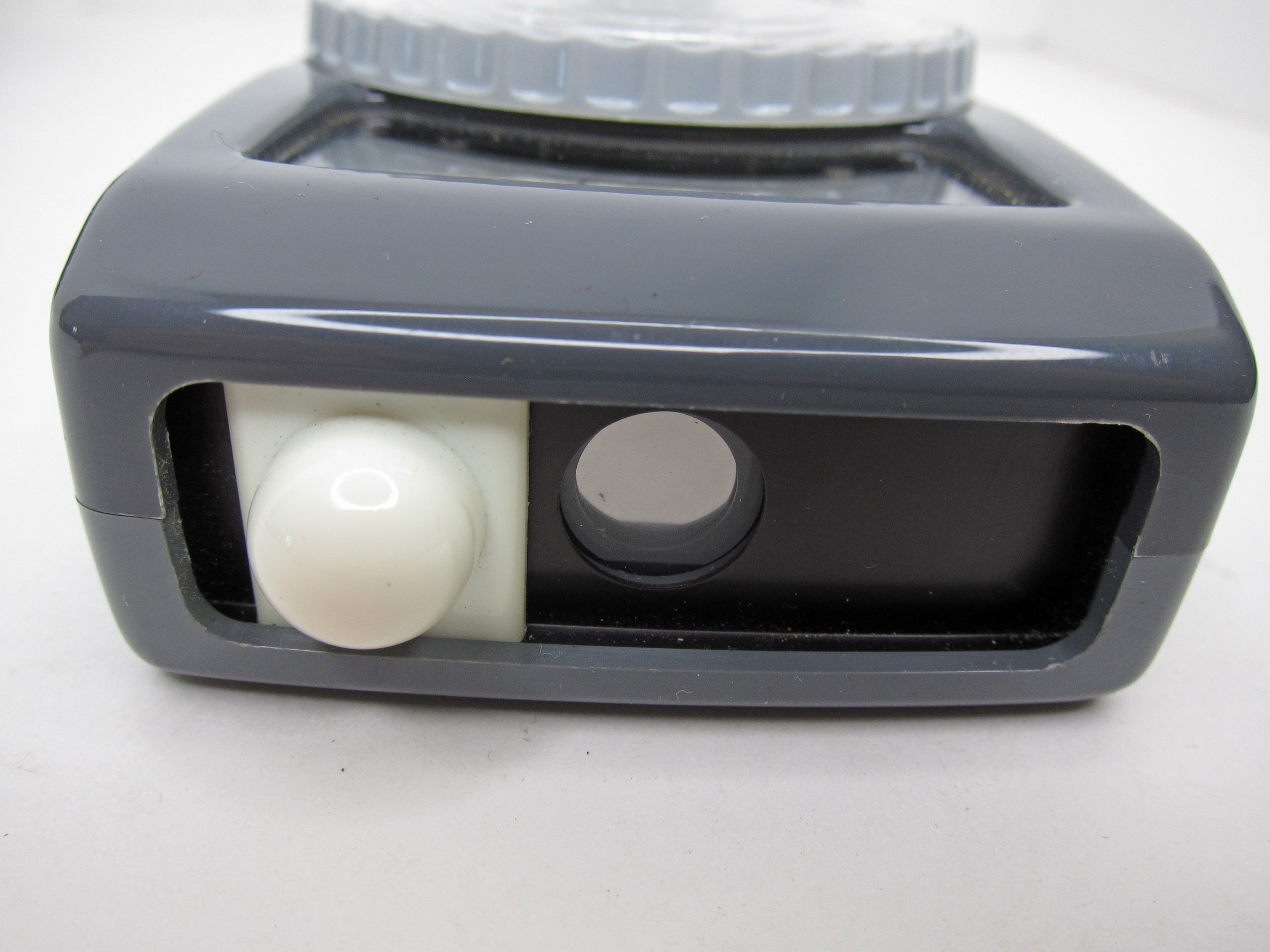

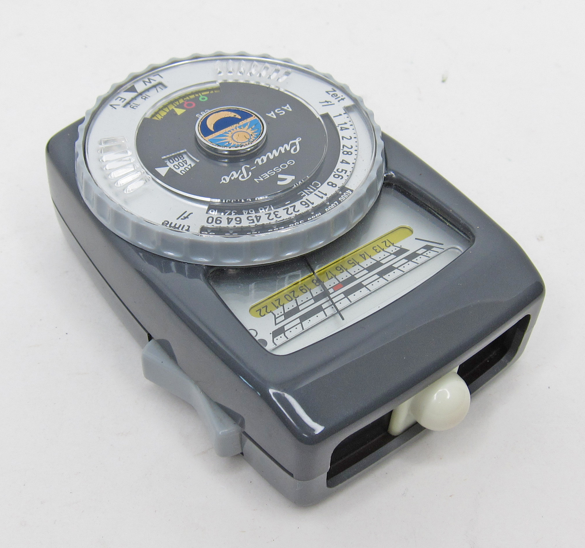

In good working condition. Requires 2 625 type 1.3v batteries (ie wein cells, or adapters...) -- not included.
I tested this with some alkaline cells, and it worked, but metered values were too high.
$25 plus postage.SOLD

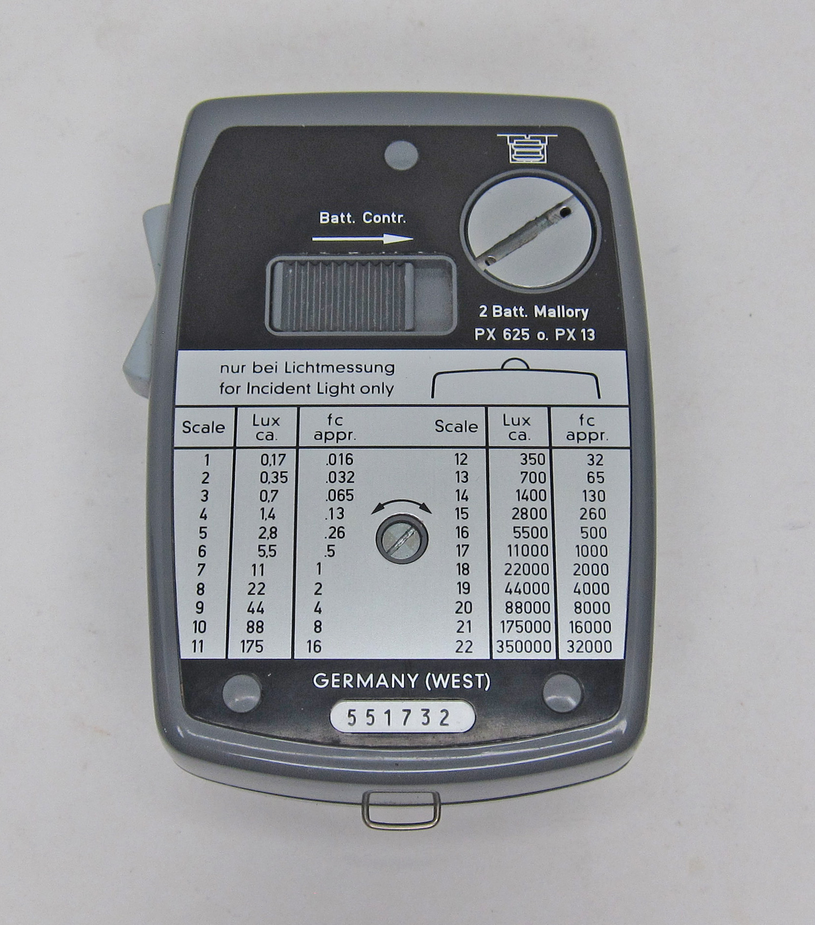

this is a pretty good deal. the problem is there are no techs out there that can or will adjust a Gossen Meter. there was a very old guy in LA who made a living out of doing just that.....but he retired last year. Gave me a referral to SpectraCine... they laughed. Contacted Gossen in Germany for service....they lacht. "We don't care about our old shit". turns out after fiddling around, the contacts needed some cleaning and my model has an adapter for 2 SR44 and unlike yours, it is printed on the back (SR44).

there was a thread I posted on RFF a number of months ago when I was having trouble with my Luna Pro. on the back it has printed 2 SR44 1.55v . i believe someone responded saying that some model variations had this factory modification. I searched high and low for someone to work on it (see above). In the end I just vigorously cleaned the contacts inside the battery compartment, placed 1.55v standard batteries and away it went.
