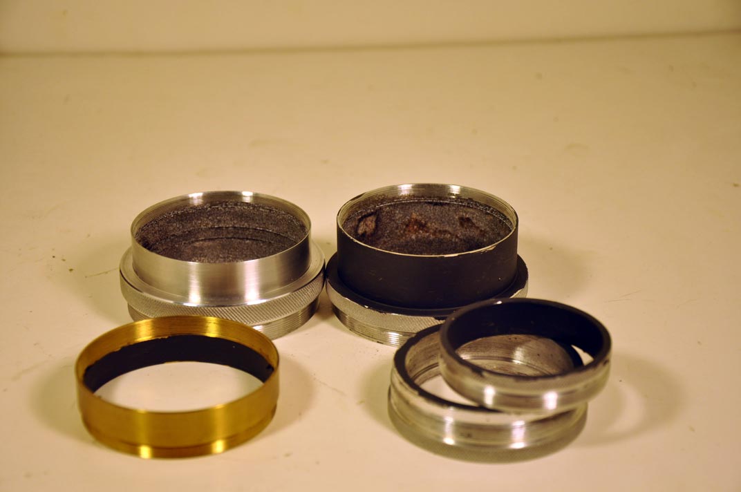

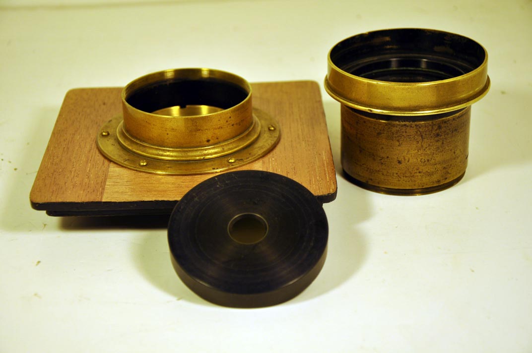

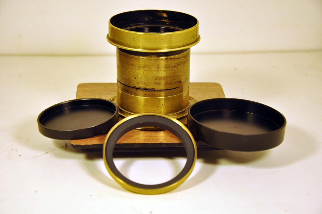

Here are some photos of the various parts included in this offering:
First, the original lens in the original barrel. Those are the Delrin lenscaps and the filter adapter.
The next photo shows a feature of this lens that intrigued me enough to buy it - the front half of the barrel unscrews from the rear half. This leaves the rear cell still mounted on the lensboard. See the thread mentioned above for photo examples. Also shown is the Delrin waterhouse stop that I made for shooting with the rear cell only in the barrel.

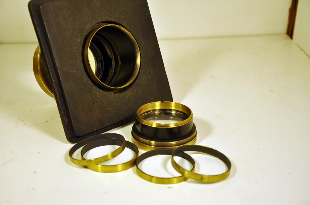

This photo shows the spacer rings that I used to vary the spacing between the elements in the rear cell.
In the rear of the last photo is a set of adapters for mounting the front and rear cells in an Ilex 5 shutter. Almost all of the photos in the abovementioned threads were taken with the cells mounted in a shutter. Would you like to use a Petzval with a flash?
Also shown in this photo is a cell casing into which the rear elements will fit. Additionally, there's a fairly useless (but too nicely made to throw out) 1/2 inch brass barrel extender. Based on something I read somewhere, I wanted to play around with altering the length of the barrel. There's an example photo in the abovementioned thread.
