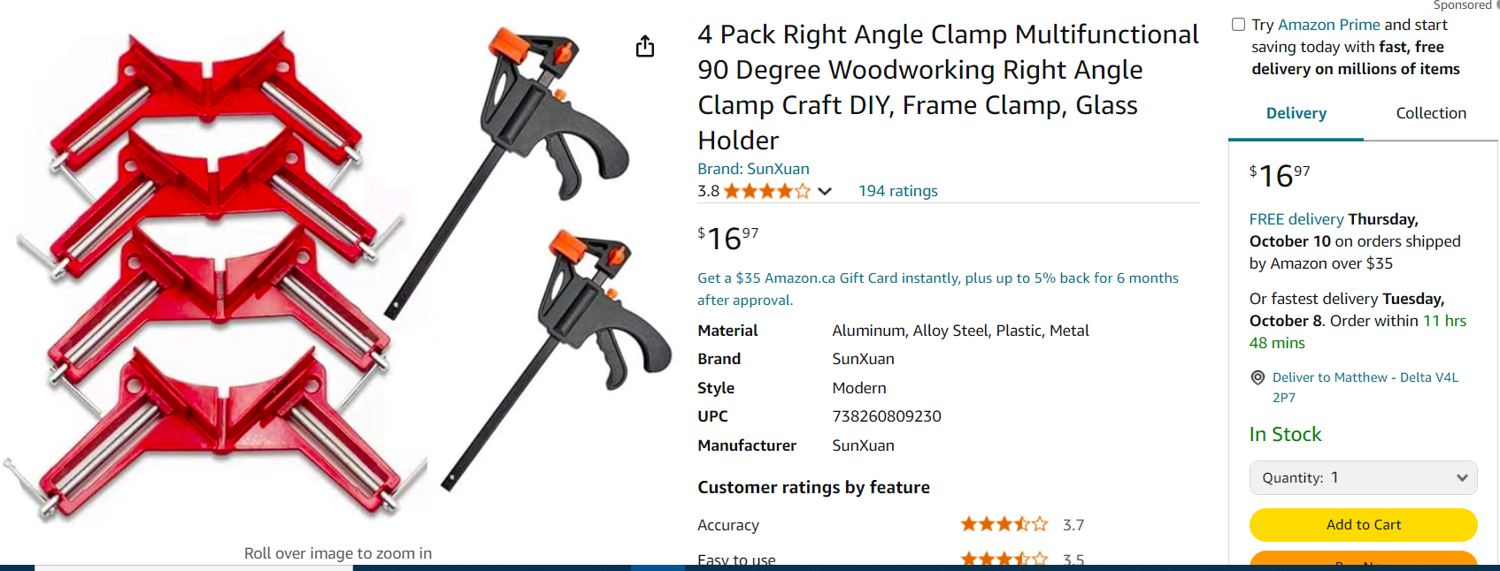

From Amazon.ca.

Just remember to check square on any tool that is supposed to hold square before you use it to set something square.
Traditional method is to simply find something with a long straight edge you can set one leg of your square against and draw a fine tight line against the other leg. Flip things so you're set against the edge on the opposite side of your line, and draw another line over the first.
If your lines overlap/cleanly parallel, then you're good to go. If not, then you have some inspection and fiddling to to, if not a return.
As for screwing in hardware I'll second the advice to go slow and only tighten each screw a bit at a time. If you're doing them often enough then rigging up a few larger right angle jigs might be worth the effort to go a step above the previously suggested corner clamps.
Errors compound over distance, and having more distance to align with better shows you the error early.
Unless Nielsen cheated out of high, and prudently so, production tolerances, frame pieces are cut on tightly calibrated machines. They'd be losing a lot of money if they marketed sections not cut to a prefect 45 degree angle.

Back when I used a lot of these frames, I would lay the loose but completed frame sections on a flat, hard surface and use one hand to hold the corner in a way very similar to a corner jig like shown above. When tightening the screws, I found it helpful to tighten one to just snug, then back off a turn. Tighten the other the same. Then switch back and forth between screws tightening just a bit each time. Tighten enough just to hold. Flip the frame over and check the corner. If not right, rinse-n-repeat. Sometimes, I had to do this process 3 or 4x to get the corner right.
Thanks. That's essentially what I've been doing, but I'm still not getting the corner as perfect as I'd like. From face on it looks fine, but there is a small gap visible when looking at the side. I might try a corner jig and see if that makes life a little easier.
Of course the YouTube video posted by the vendor makes it look trivial, but they never do show a close-up of the corner once they're done 😉

And I was referring to testing the clamps proposed to hold the pieces while tightening them. Holding two pieces cut to a precise 45 degrees in a tool that does 89 or 91 degrees isn't what I would call 'helpful' if you want tightly closed seams.
Ah ok, my Keyboard and brain did not work together then. My main point is these frames were never meant to need any device to screw them together.

A photo of your result would help. What you’re describing is abnormal. A corner jig would help bring wooden pieces together not metal.
And one key point in assembly is to keep the whole frame on a flat surface for tightening, but finger pressure on adjacent pieces should be all that’s needed.
