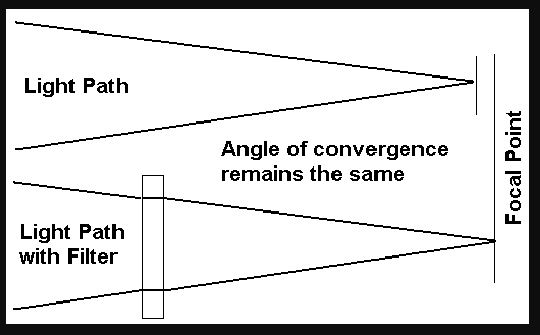

The simplest explanation is probably that the camera/lens system was designed to operate in air, only, inside of the camera. When you insert a filter inside of that space the focused image will be formed at a slightly greater distance. This is a result of the filter material having a higher refractive index than air. (Light behaves as though it were "slowed down" inside of a higher index material. )
The diagram from monopix demonstrates the concept.
FWIW the same thing also happens in front of the lens; it's just that the subject distance is so much greater that the small distance shift due to the filter is usually insignificant.
