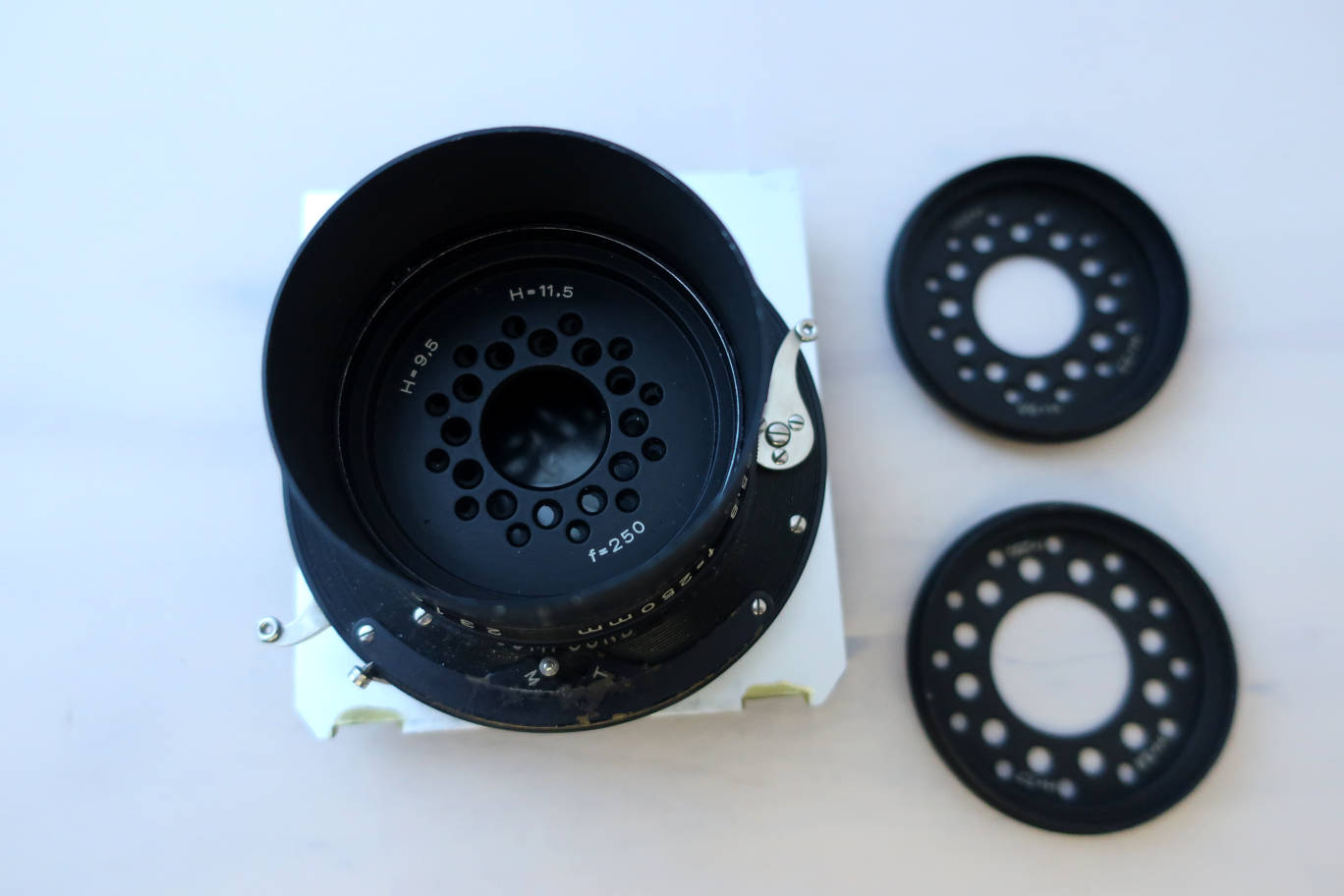

the rodenstock imagon is a barrel lens with front mounted shutter. it's an ultra short barrel, but nevertheless...
you can remove the filters from the front of the lens.
for more information https://www.oddcameras.com/linhof_super_technika_IV.htm it's at 2/3s of the page.
