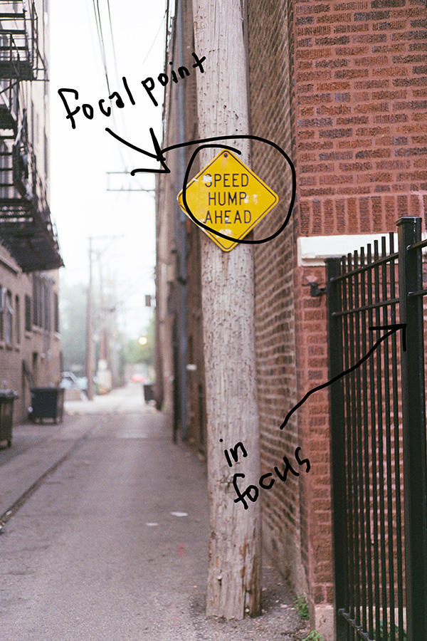

Hey everyone! So I finally got my paws on a Leica M3 and a 50 f/2 Summicron version 3. I totally love this set up but I'm running into some nasty front-focusing issues across the range of focus. It seems I have better focus towards minimum distances but I still can't nail a tack sharp exposure. The 50 cron just arrived from a CLA so I'm already stretched on money.
I tested the rangefinder at infinity on some sailboats towards the horizon and it appeared to be properly aligned. It is a pretty foggy afternoon in Chicago though...

P.S. I brought samples.

Difficult to believe it's the lens. Front focus, or focus shift as it is otherwise known, occurs on some wide aperture lenses (typically f1.4 and under) when they are stopped down slightly, usually showing around f2.8 to f4. A misaligned rangefinder is much more likely.

Thanks for the reply. I really hope it's the RF and not the lens.. Sherry Krauter also mentioned it being more likely the RF being at fault. I do have some additional photos taken stopped down and they show slight signs of focus shift.

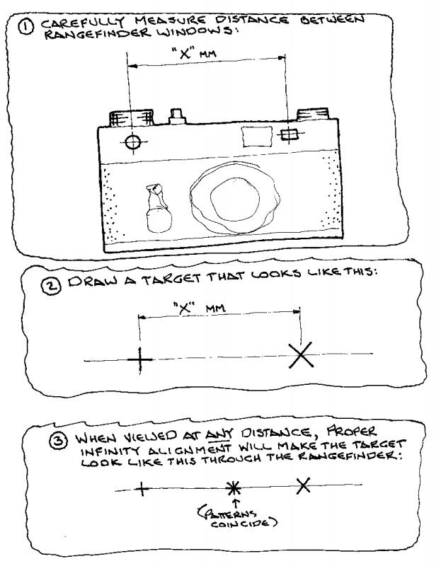

The lens and patch hits on infinity so it isn't back-focusing. From what I've read, that means I'll need to adjust the horizontal eccentric screw clockwise.
If I were to do this indoors, does anyone know if this diagram actually works?
