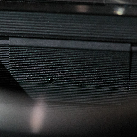

Hey @koraks it's been a while... I noticed something odd with my EOS 30 the other day. There seems to be a bump at the back of the secondary mirror of my camera as seen in these two shots:
I suppose that's the cause of my problems, perhaps yours could have something similar?

I just checked: no bump. This would also be inconsistent with the evidence that the problem is NOT there with the 100/2, but it DOES occur with the 50/1.4 If the problem were associated with the mirror, it would occur with both lenses (and likely even more pronouncedly with the 100mm). Additionally, it doesn't really fit well with the fact that there was perfect alignment between the autofocus and manual focus. The bump on the AF mirror would likely create problems with AF, but not with MF.
