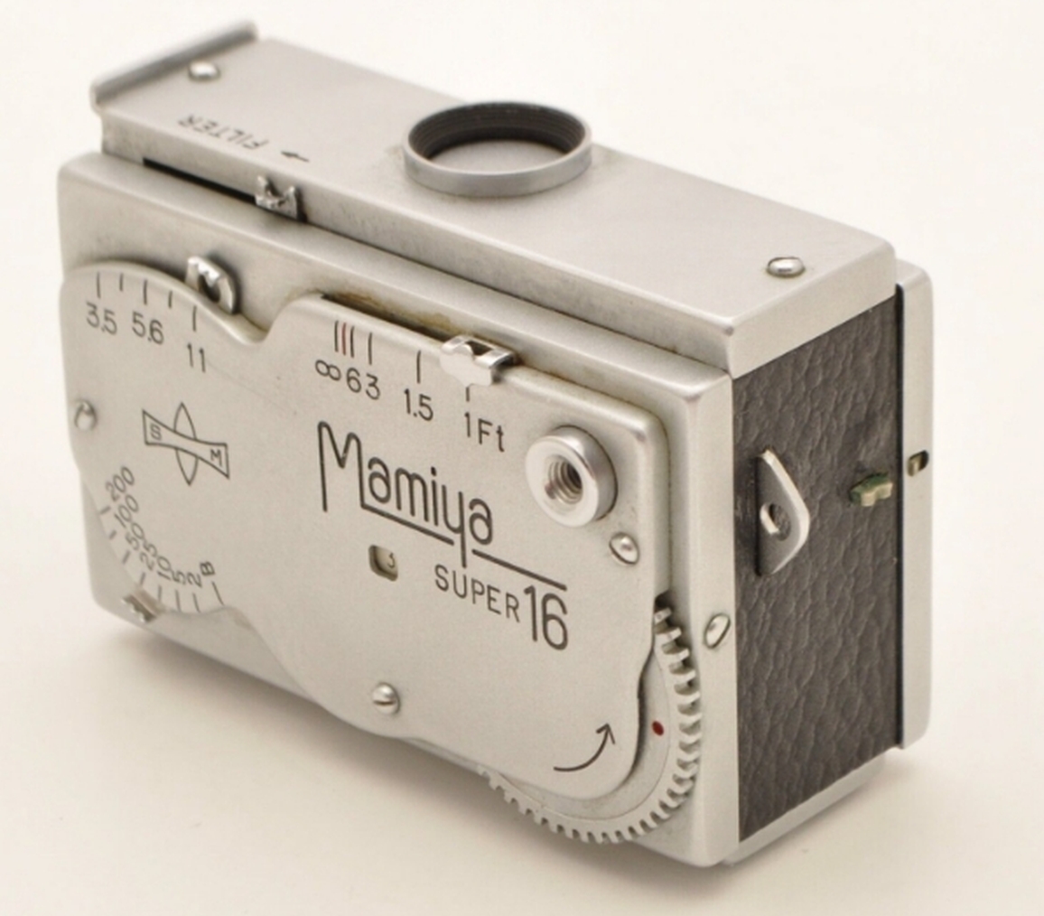

My personal favorite for repairing is the Mamiya super 16. However, I only deal with subminiature cameras.
- This camera is made of excellent materials.
- It is easy to open and disassemble.
- The parts inside are easily accessible.
Even as a beginner, I managed to get the escapement and thus the shutter speeds working again.
By the way, it also takes great pictures...

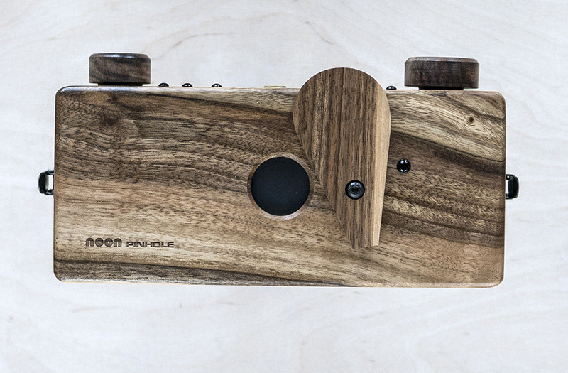

My Noon pinhole camera was probably the easiest :smile:
