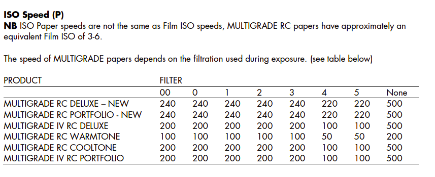

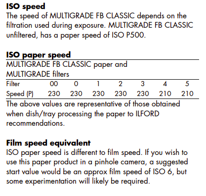

The ISO speeds of papers can give you a clue:
Ilford Multigrade (V) RC:
Ilford Multigrade Classic FB:
I'll let others describe how to make use of this :smile:.
