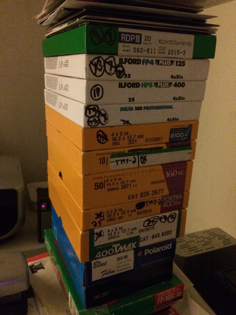

I have a small freezer full of film. At some point I must have pushed something against it and the door was opened a crack. When I opened it the box ends were soggy and moldy. There is ice around everything freezing it in place. It was mostly large format film. Both color and b&w. Some boxes were opened some are not. What are the chances that any of it is usable?

Ah sorry to hear Chris. That really sucks. If the film pouches are still sealed I think you have a good chance that it's ok as the paper has a bit or plastic lining. But on open sheet packets I would be wary of emulsion damage due to the humidity. I would give up on anything that's out of the original packets, maybe use them for testing, or develop the open color as black and white. It wouldn't be worth the effort to carry and setup your large format gear and shoot bad film. Also tossing the wet boxes and letting the film air out a bit in a dark room with good air circulation, then repacking into ziplocks with silica.

Basically all of the film is good, the boxes are just bad, the 35mm comes in plastic cans so that's fine, the 120 is sealed, and the sheets are certainly fine if it's Kodak or Fuji because they seal them, if it's Ilford or some other euro brands, you might have some water issues because they just fold them over.

I don't shoot LF so I don't know how it compares but I had several boxes of paper sit touching the back of my fridge. They were pretty soggy.
The paper had all been opened but the black plastic liner kept it perfectly dry. I wiped of the plastic and put them in a box whist I dried out the paper boxes. Then they went back in the fridge, much more carefully.
If LF packaging is similar I think you'll be fine.
