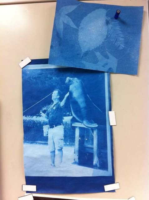

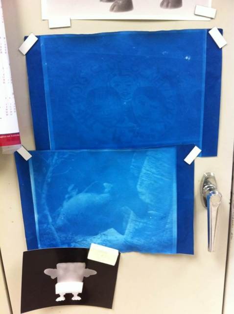

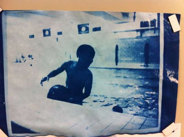

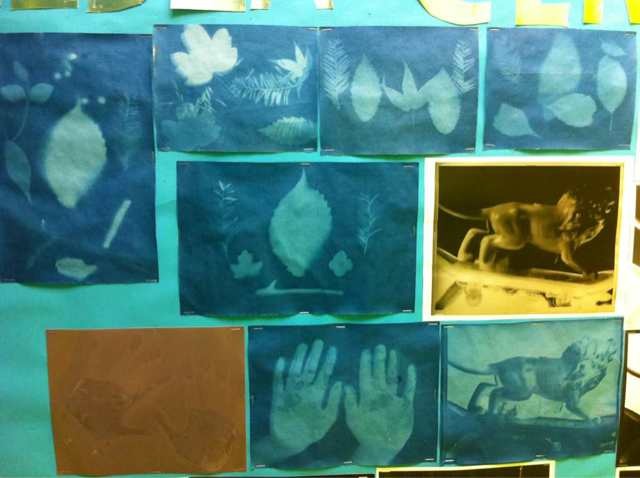

As promised here are some of the completed prints using the ortho litho film.
ImageUploadedByTapatalk1344566441.881546.jpg ImageUploadedByTapatalk1344566466.685284.jpg ImageUploadedByTapatalk1344566485.186221.jpg ImageUploadedByTapatalk1344566505.404897.jpg ImageUploadedByTapatalk1344566568.294266.jpg
The one with the toy lion actually has a sheet of the litho film displayed with it in the hallway, and to the right (not shown) is a regular positive print of it, and a print showing the negative on paper as well.
Some came out better than others, but keep in mind that these are made by kids, I teach them the process, supervise, help along the way, and of course do a few demos first but they are the ones doing the photography and printing steps.
