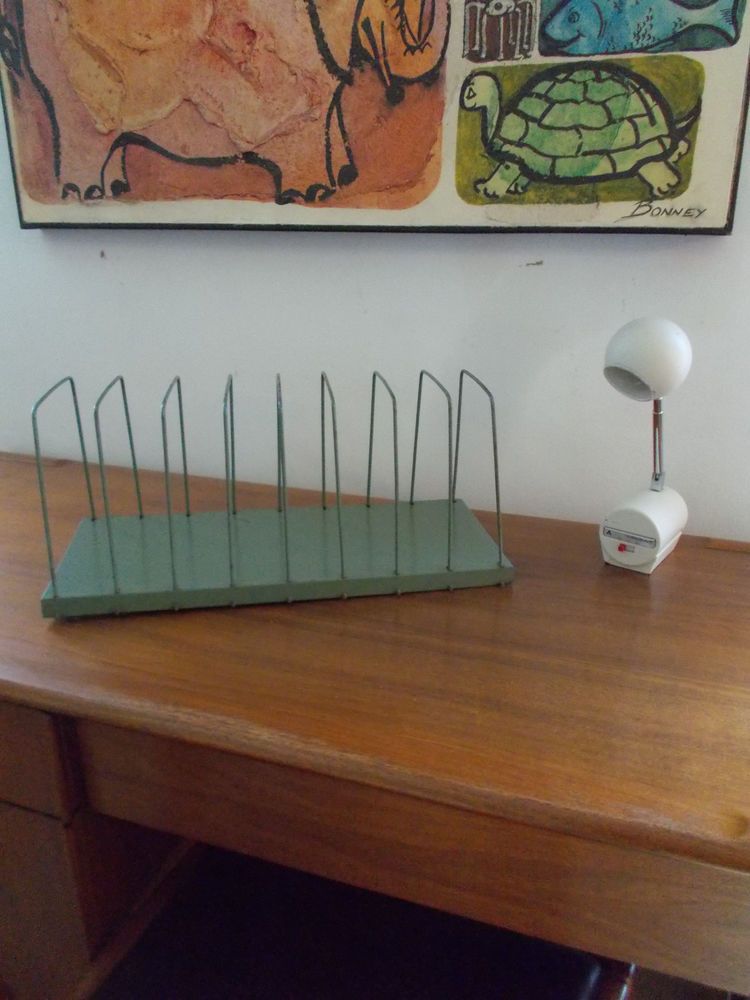

Look for one of those old wire stands for holding LP records - that is what I use.
Make sure the wire is coated/painted/stainless steel.
Here is an image of one from the web:
I've never seen one of those for sale, but I will keep my eyes open.
