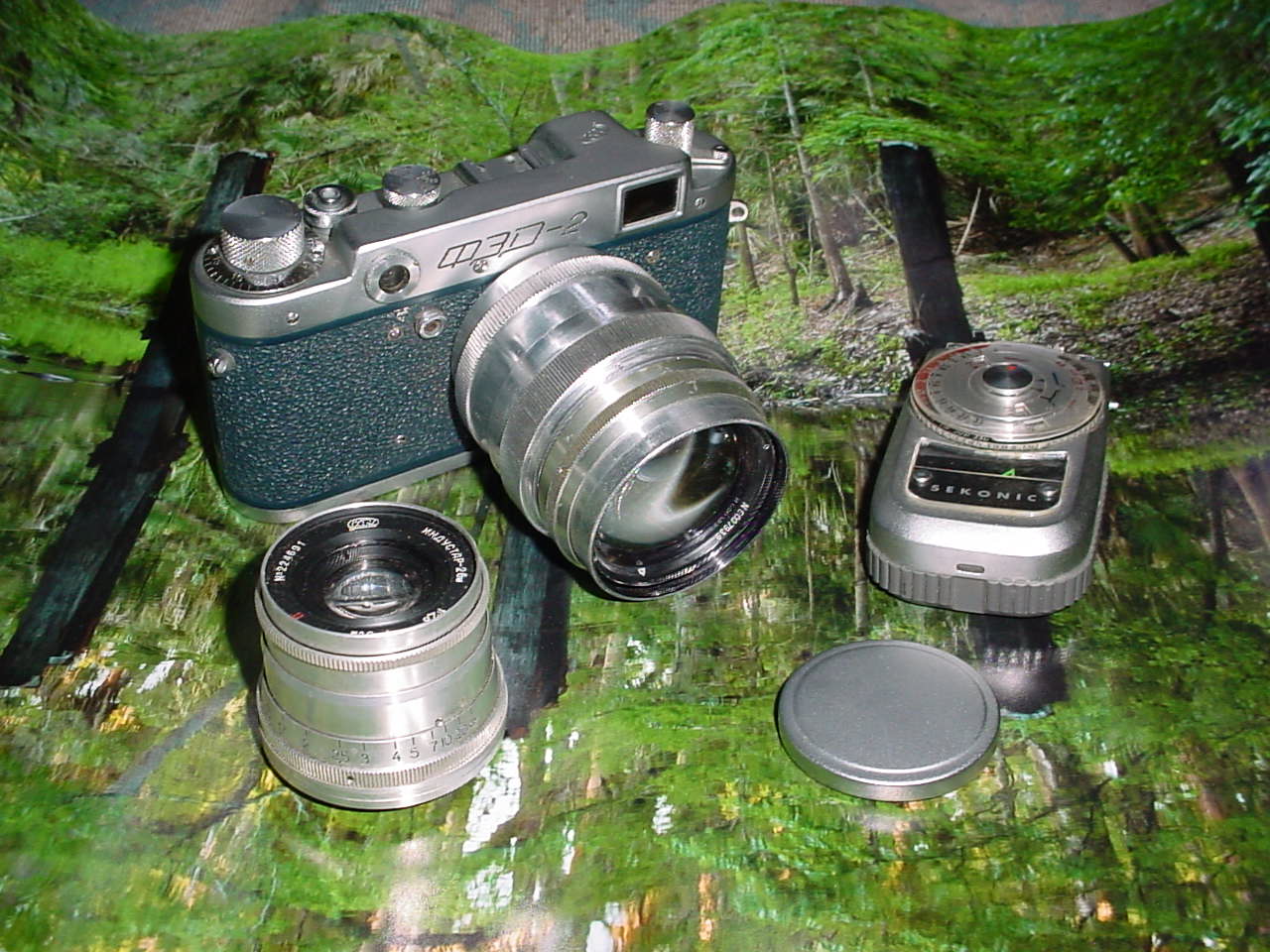

I got a FED-2 locally!!! Can't believe it, decided on the FED-2, searched eBay and by a stroke of luck remembered to check local listings, found this little gem 20 miles away. Messaged the seller, they agreed to cash payment and local pickup. It has some sort of Industar lens, a 50 2.8, Sekonic light meter and my 85 works flawlessly on it.
It will need a CLA, which I will tend to this week. I CLA'd my Kodak 35RF and I specialize in laptop repair so this should be simple as there are no electronics.
I will build a complete system around it, already got 2 of the trifecta to make a kit. Feels great to have an interchangeable RF system now.

Very nice catch! I like the blue bodies; they look black enough to be dignified, but on close inspection the blue gives them a little character.
That's an Industar-26m, the standard lens on most FED-2 bodies; it's a Tessar type and can be pretty darn good.
There are a lot of fiddly little bits to make up for the absence of electronics, but it's a fairly simple camera on the whole. No slow-speed escapement system, which helps. That said, the one time I went into mine to try to fix the shutter tension, I made things worse rather than better...

Yes, except for the concern about alignment differences between Soviet and "real" M39 focus threads. It shouldn't be a problem with wide-angle lenses, which means that you might think about something like the Voigtlaender wides as well as the fSU originals.
I'm not sure what the Industar 28 is, but the Jupiter-12 is a seriously nice lens, or at least my sample is. You might want to play with that Industar-26m for a while before deciding if you need the 50/3.5 as well; I decided I really like one of my "stock" lenses and didn't need another normal.

I thought about the leica clone but in all actuality I'll probably CLA the Tessar as I have almost all the tools save the lens spanner and that is on order.
Plus from what I've seen on the Tessar clone it's absolutely fantastic. There's a whole slew of 50mm lenses for the FED-2 I might just keep this one.

Did the CLA on the FED-2b, it's ready for battle!!! Shutter speeds check out fine, no pinhole leaks, everything is good to go on the body. The vertical parallax adjustment is a wee bit off, I can see it if I look hard enough, but the test roll will go in tomorrow. :smile:
The 85 is fine already. The Industar will need a minor CLA.
I did the entire CLA while listening to Soviet communist march songs and anthems. :laugh:
It isn't my bud's Leica but dammit you can't get too much closer without actually getting one. Maybe I got a good copy.
I bet your Fed-2B will work fine and be fun to use the J-9 on. I've recently discovered J-9s, and they're as good as the 50mm J-3, very nice rendering. What I find interesting is the rising prices of Soviet Barnack style cameras, and falling for Leicas. The other day I searched for early Fed 1s and came up with several that had sold for over $150. Some over $200. The average was about $100. Then I searched for completed Leica IIIcs from the post-war period. Their average price (bodies only) was about $200.

make sure you actually check the focus before you take serious shots with it
a jupiter 9 that's been calibrated for non russian rangefinder cameras will focus improperly on a fed. at 85mm and f2 that could become a huge problem.
shimming it to match your fed is pretty simple work though.

Zenit SLR lenses will mount but won't focus correctly at all. All Leica thread mount (LTM) lenses will work, except for pre-war FEDs.
I've had no major trouble with mine, knock on wood. My first one had a bad light leak around the film gates, which I was able to fix easily by bending the metal back into shape, and on both of mine I've used thin strips of electrical tape to keep the diopter controls from wandering.
