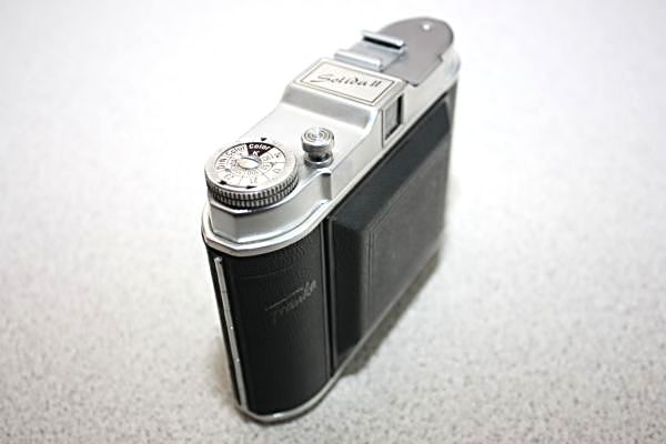

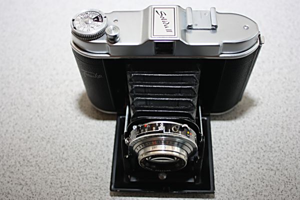

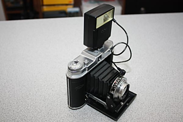

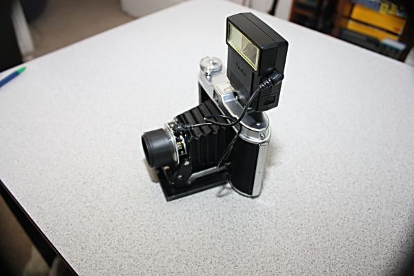

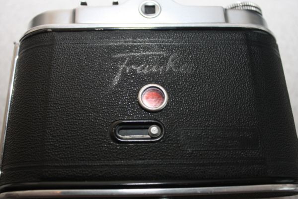

Franka Solida ll
Here's a few pics of mine. As I mentioned it is really fun to use. It is strictly 6X6. The lens is a Enna Werk Munchen Ennagon 1:3.5, f= 7.5cm, Speeds are B thru 300. Aperture is 3.5 thru 22. I use a old Vivitar flash w/ sync. And I made my own lens hood from a rubber section of rifle scope cap. These are noted for some lens flair and I have not had a problem with it since making the hood.
One of the biggies with this camera are getting your distances correct! When I pace something off I've always been within an inch or so of measurement. Then again, I worked in the woods many years. I plan on picking up a little rangefinder in the future for old age and senior moments haha! You can mount it on the cold shoe. Often I leave distance on the lens set at infinity and just take shots from 10 ft on out. But for closeup I would measure accurately.

Now I could use some advice from someone more experienced w/ these.
When I shoot color what setting on the top dial should I use, there is a color "T" setting or a Color "K"
setting, along w/ your ASA/din settings? Say it's fuji Reala ISO 100? On black and white I just set the proper ASA.
Thanks
jnoir
Aug 30, 2009
109
Mdz
T (or CT or DAY, depending on the camera) is for color reversal film, daylight type. K (or CK or A) is for color reversal film, artificial light type (incandescent lamps with 3400º Kelvin)
Fuji Reala should have its own setting, N (or CN) for Color Negative film, daylight type.
On these cameras, that ISO dial is simply a reminder for your convenience, and it has no effect whatsoever on the final result by itself.

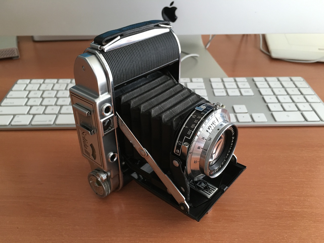

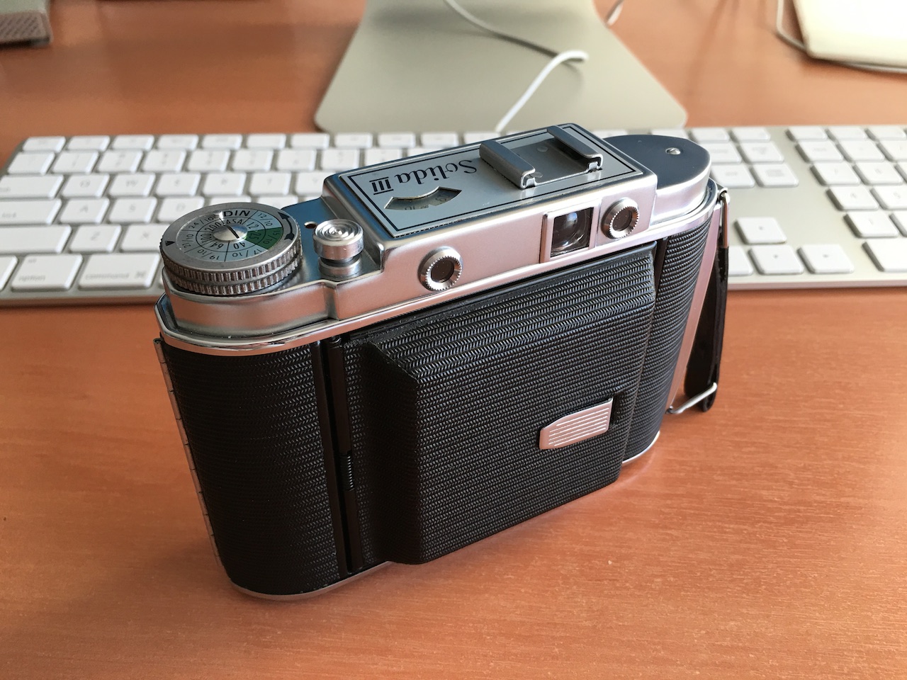

Old thread but we are talking about old cameras right?
My Franka Solida IIIe
