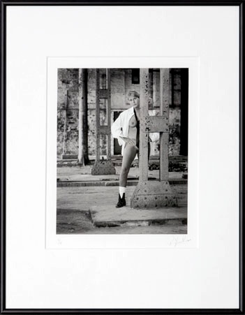

For my 11x14-inch prints, I picked a 18x22-inch black aluminum frame.

...I have always calculated the mat based on the border I'm looking for. You just have to get into the math of figuring out whether you want a consistent width all around, "bottom weighted" or something else...
This would not work for me. How do you deal with mats and frames being different for every print?
I do this in groups. 8x10, 11x14 and 16x20 prints all have their set of mat and frame sizes. Each print has slightly different dimension, but I only have to deal with three different mat and frame sizes. The borders are close but not equal in size. This is easier to store and maintain supplies.
