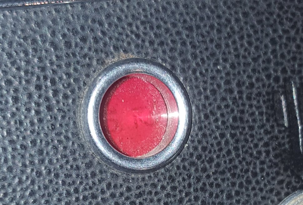

With some older cameras the red windows become either rather opaque or scuffed, therefore difficult to see through. I had to return a nice Zeiss 69 because of excessive abrasions of red window. As you roll, you should see a series of circles, gradually getting larger. This is to tell you to slow down and be ready for “1.”

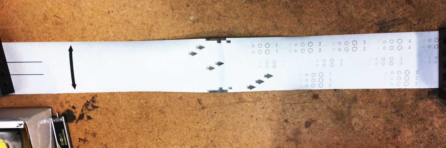

Ilford has four circles on HP5, no idea if they change it up for different emulsions. Be ready, they are right next to each other. Here's the backing paper from a roll of HP5, for 6x9 you will be seeing the bottom row, most widely spaced-

By God those markings are faint! I see on this image that I have been past several of these circle things, but I didn't see any numbers. It was indoors in not too good light. I tried just now to wind carefully a bit further in good light. Saw the circles, an then the number 12! So as I feared, the whole roll down the drain. That's rather embarrassing, I guess :redface:. Oh, well, lesson learned: Only take this camera out in the brightest sunshine or with a powerful head lamp. Why on earth can't they print in proper black?

If the dirty red window illustrated belongs to the OP, that could be part of the problem.
