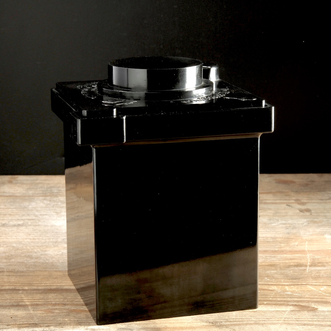

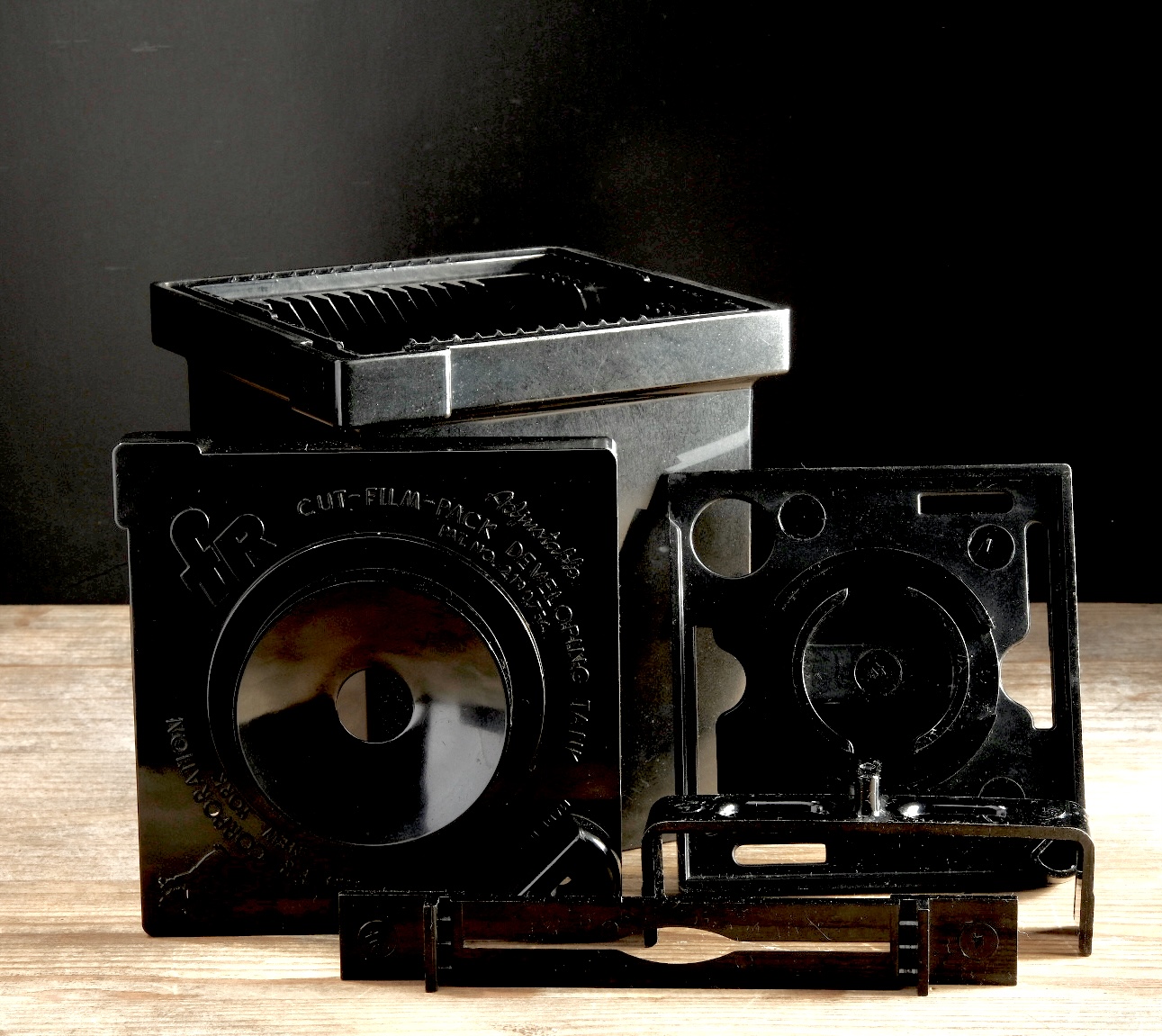

For the aficionados: a US made "cut-film-pack-developing tank" for multiple formats between 4"x5" over 9x12cm to 6x9cm.
Made of hard plastic by the RF Corporation from New-York, said to be a relic from the days...
Hardly used, no cracks nor any damage, all the accessories are present, the variable format holder too. Holds 12 sheets.
Selling for € 50.- + shipping
