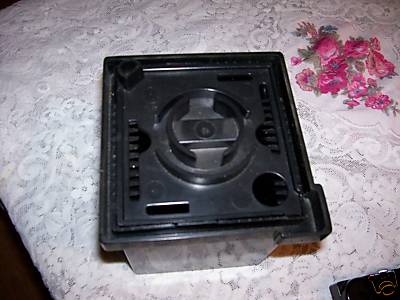

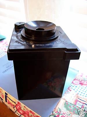

I just got this FR adjustable tank in the mail last night. I get the basic idea of it, and I think I see how it forms light traps so I can use it in daylight and I'll figure out where to put the sides for the various formats. But, I don't understand why the one corner is square and why the diagonally opposite corner has that little protrusion on the outside. I thought it would be a spout for emptying but I didn't see a hole all the way through (maybe I missed it?) Anybody have instructions for this thing? How much liquid do I need for the various sizes? Best method for agitation to get even development (since I obviously can't invert it)?

It's the outlet where you pour out the spent developer, like the lip on a jug.

Didn't look like there was a path for drainage there - I need to look closer. So the opposite corner protrusion is a vent for pressure relief?

I guess so. I have a tank in the UK that I've not used yet, I bought it because my Jobo's aren't adjustable and I want to process 9x12's. The corner's identical.

The square corner with the lip is the spout. The opposite corner with the protusion is an air vent to allow air in as you pour the chemicals in and out.
For what it's worth, I have 2 of these tanks. Had them for years. Got them with in a package deal with a bunch of other stuff. After using them a couple of times when first getting into 4x5, I found they almoxt impossible to use and get good results. Gave up shooting 4x5 for a few years. Now use mostly the Combi Tank system. They work much better. Also have a JOBO tank but haven't used it yet. I figured the JOBO would be better if I only had a couple of sheets to develop.
As far as agitation with the FR tank, when I used it, all I could do was some gentle side by side rocking. I tried to rock it parallel with the film sheets, not across them so as not to knock them out of the tracks.
Wait until you you fill this tank up with 52 oz of developer. Another reason to not use it.
