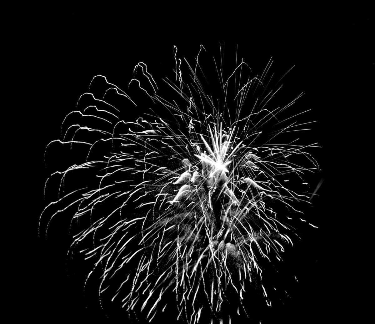

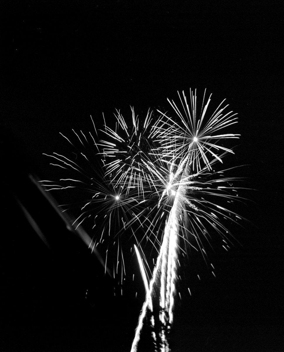

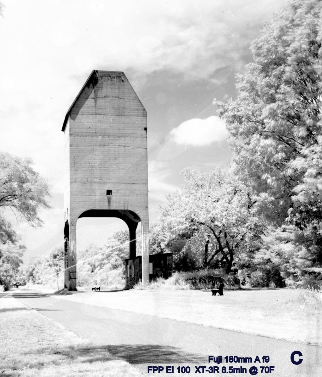

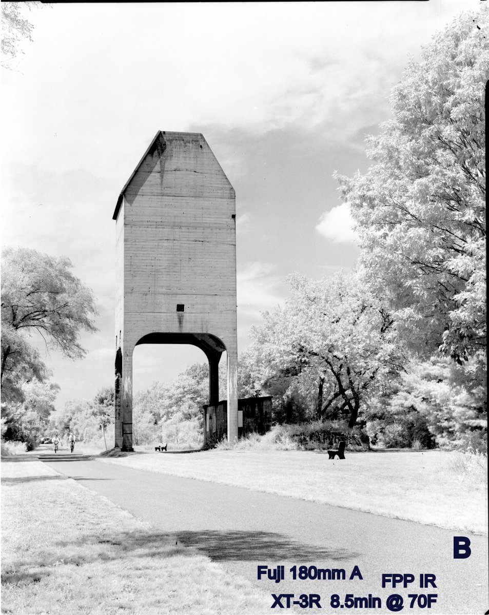

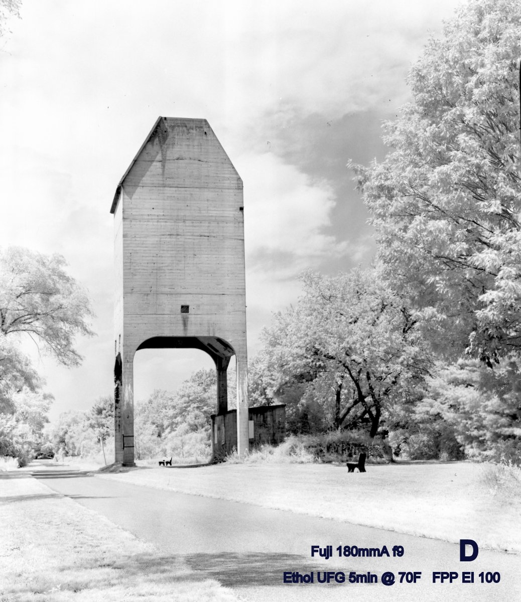

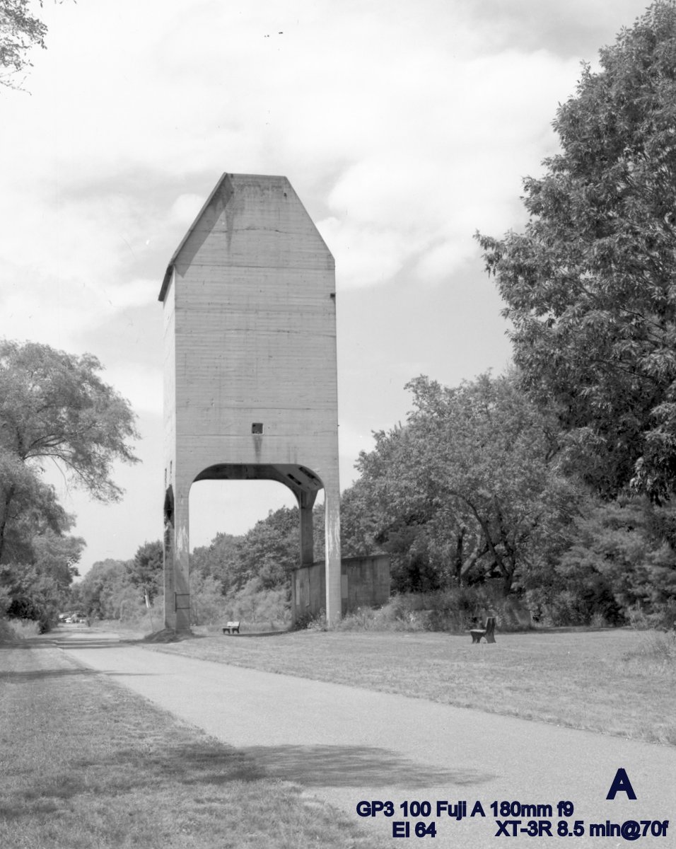

Here is a look at some results.

I think I would rate this FPP IR 200 film at EI 160 and use either UFG or XT-3R. The fireworks shots I took with the 1898 Cyclone Senior Falling-plate box camera sitting on the ground and holding the camera on my knee. Just threw them in for Andy. I used HP5+ and XT-3R for those. I'll be going out somemore with the Cyclone camera, but it won't be with FPP IR 200 that's for sure. The first "A" steam locomotive coal tower shot was not FPP200 IR. I used Shanghai GP3 for that one, and it's just a reference shot.

Thanks Andy! The results aren't top-notch since I wasn't feeling 100% and it was just a practice run anyway. You can see shot "C" has two creases across it. I honestly did not even know I did that or how.
All the sheets so far have a corner cut off. I had to waste a sheet since I was looking for the typical notches on the narrow edge. My main problem is that when I came back from that wonderful year long vacation to Southeast Asia that my Uncle Sam sent me on I came back with severe nervous system problems and have almost no sensitivity feelings in my extremities, such as the tips of my fingers. My fingers and those thin sheets just don't see eye to eye. That's why tray processing sheet film is extremely hard for me. The SP-445 sheet film tank still isn't easy for me, but pretty darn good anyway.
