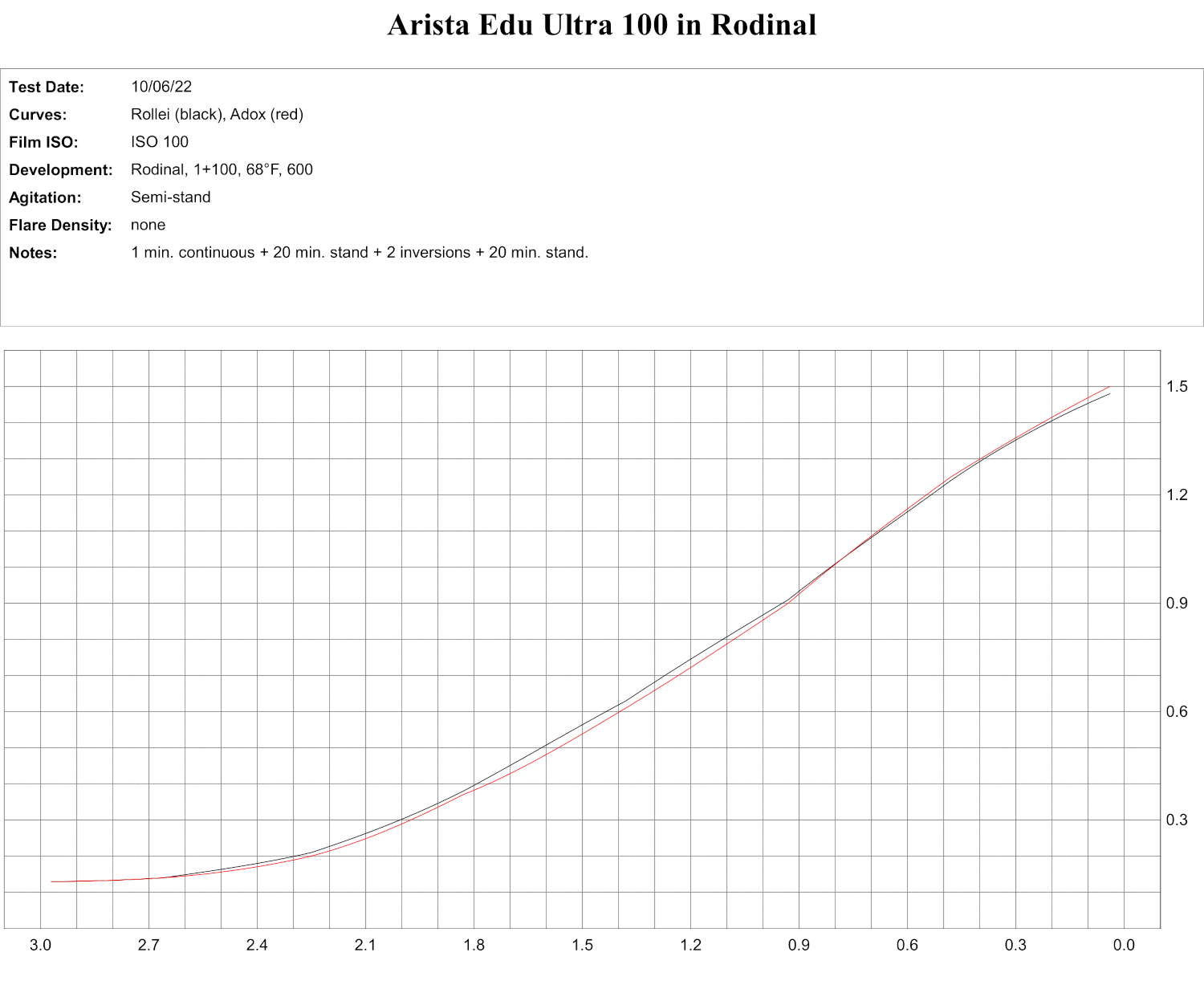

@aparat : in the post I quoted above, there doesn't seem to be much of a shoulder in the graph. I was surprised, as I though Rodinal at 1:100 would have a compensating effect, compressing somewhat the contrast of the highlights. Am I reading this wrong?

Yes, you are reading it correctly. I was surprised by it, too. I did another test a few weeks ago, trying to see if the Adox Rodinal produces similar results to the Rollei R09 One Shot, and, at least in 1:100 semi-stand, they are very similar, but neither is showing significant compensating effect. I am not denying that such an effect is possible. Its just that it's not very pronounced in these examples.
