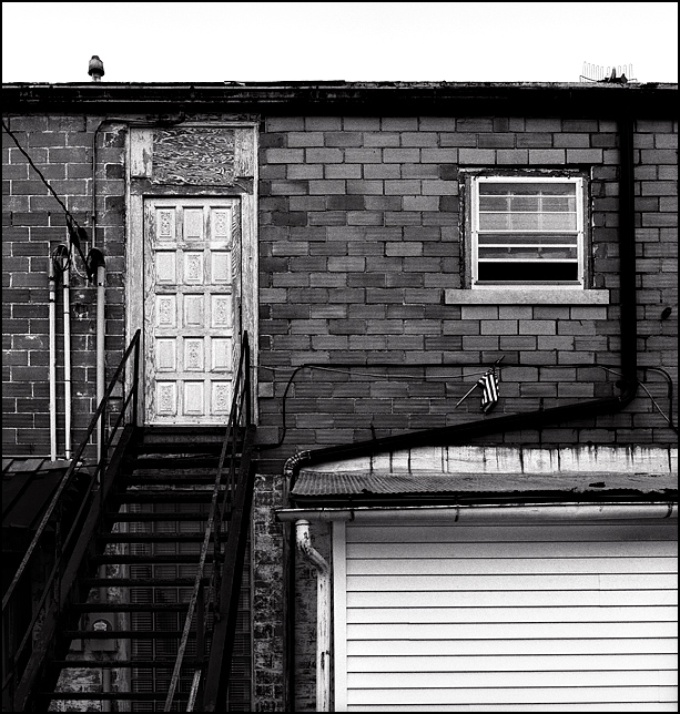

The image chriscrawford posted has a typical Rodinal look, strong contrast. Note, Rodinal is agitation sensitive. Ilford data guide says to use 16m with Rodinal 1:50. I think this is too strong a ratio.
