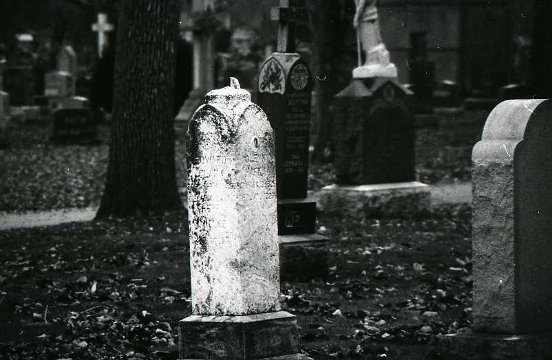

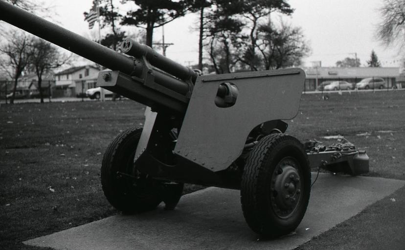

I developed it in Rodinal and here are the results. I cant believe i made this mistake and ruined the roll of film. Thanks for your help.

They look ok. And you're not the first to do this! Why do you think they made cameras with DX Coding?

They don't look bad at all! What makes you think of them as ruined?

Rodinal isn't known for getting the most speed from films. I find it as much as a stop slower than box speed with some films (unless adding Vitamin C or doing semi-stand). As Jim A. mentioned earlier, there are other developers that tend to yield higher effective film speeds.
Even automatic cameras that set film speed from a DX coded cartridge don't take this kind of adjustment into account.
Try to make a habit of changing the film speed on the camera body or light meter just before you load the film. I try to do it just before taking the film out of the packaging for loading.
At least you'll remember to check the meter's ISO setting for a while now.

I think they are pretty good. If this doesn't give you much comfort then take some comfort in the news that you have given at least one other member( me) a good deal of hope that should I make the same mistake or have to expose at EI400 to get the shot then I'll have a very good chance of a reasonable neg from which to make an equally reasonable print.

Try printing on a one grade softer paper, and cut your exposure by a stop and they should turn out fine. You actually have to work at it to FUBAR B&W.....
