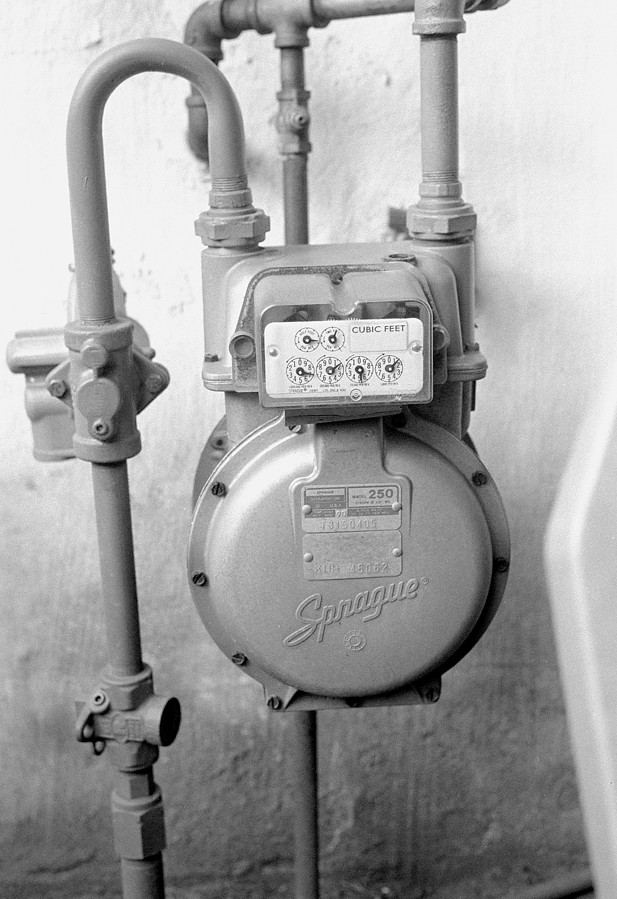

Well, I have a few done and while these are not Pulitzer Prize winners, just tests around the house, there was a two fold purpose. To see how the DR Summicron lens compared with the Zeiss and to see how FP-4 and Rodinal played together-whether it was as I remembered or changed.
I'm happy to say it looks as good as ever with Rodinal. Moreover, the DR lens gave the Zeiss a fit in the sharpness department. It was just a tad less contrasty than the Zeiss which is to be expected since it's a much (1969?) lens compared to the Zeiss. I had to bump up a bit on the DR but not much. It's hard to say which is sharper. You be the judge. I'm happy with both of them.
So, without further ado, may I present for your viewing enjoyment my first guest...Tigger!!
This one with the DR lens.
