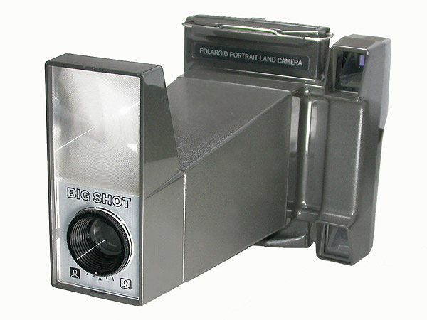

On the subject of FP100c, can anyone recommend a dedicated Polariod camera to use it?
Preferrably something with a flash.

The Big Shot is great, if you can find the flash bulbs.
