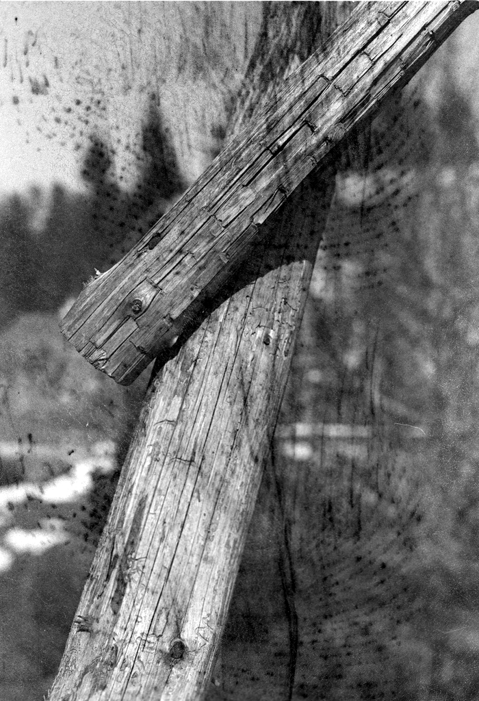

For example, Kodak Plus-X, exp March 61, shot couple of days ago at EI50 (fingermarks are not mine, it was a partial bulk roll I acquired):
