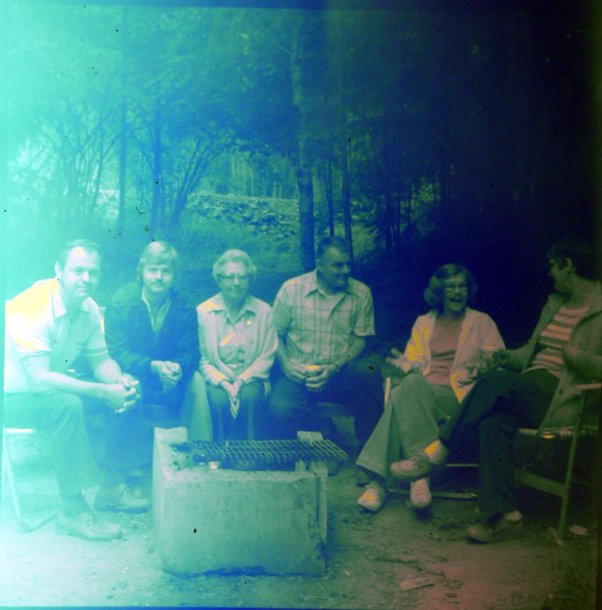

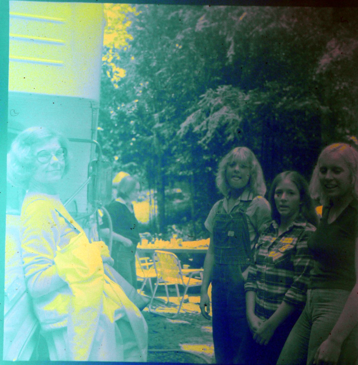

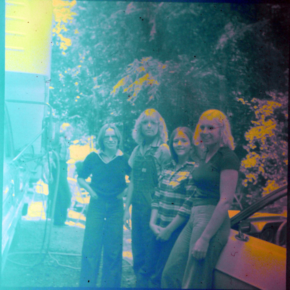

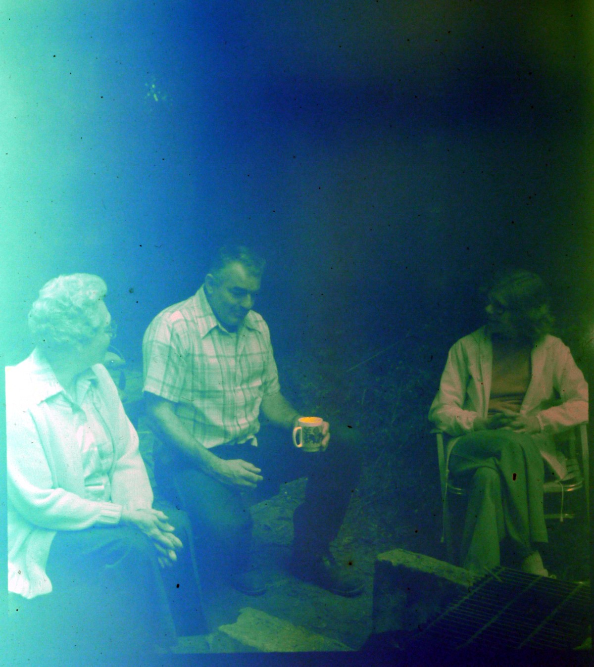

Apparently, the silver image held up quite well. The color dyes took a big hit, leaving "green and white" pictures. Even the orange mask appears faded, although I have noticed that when negative film is cross processed the orange comes out more pinkish. The orange/yellow showing here mainly came from the d!&!+@l processing. The original images are much cleaner and clearer, with an overall green cast and very light pink highlights. I will grant that a great deal of effort did not go into the scans.
So it looks like a camping trip with family and friends, with a 1970's feel. If I had the presence of mind, I would have tried snapping off a few more shots to see how they would look. But I rarely have presence of mind. So who are these folks and why did the last roll to be put into the camera only get four frames exposed, and then it was all forgotten about? Could it be that the photographer got a fancy, brand new 35mm SLR and never looked back at the quirky little Sawyer's Mark IV? Given the time frame that would be quite likely.
