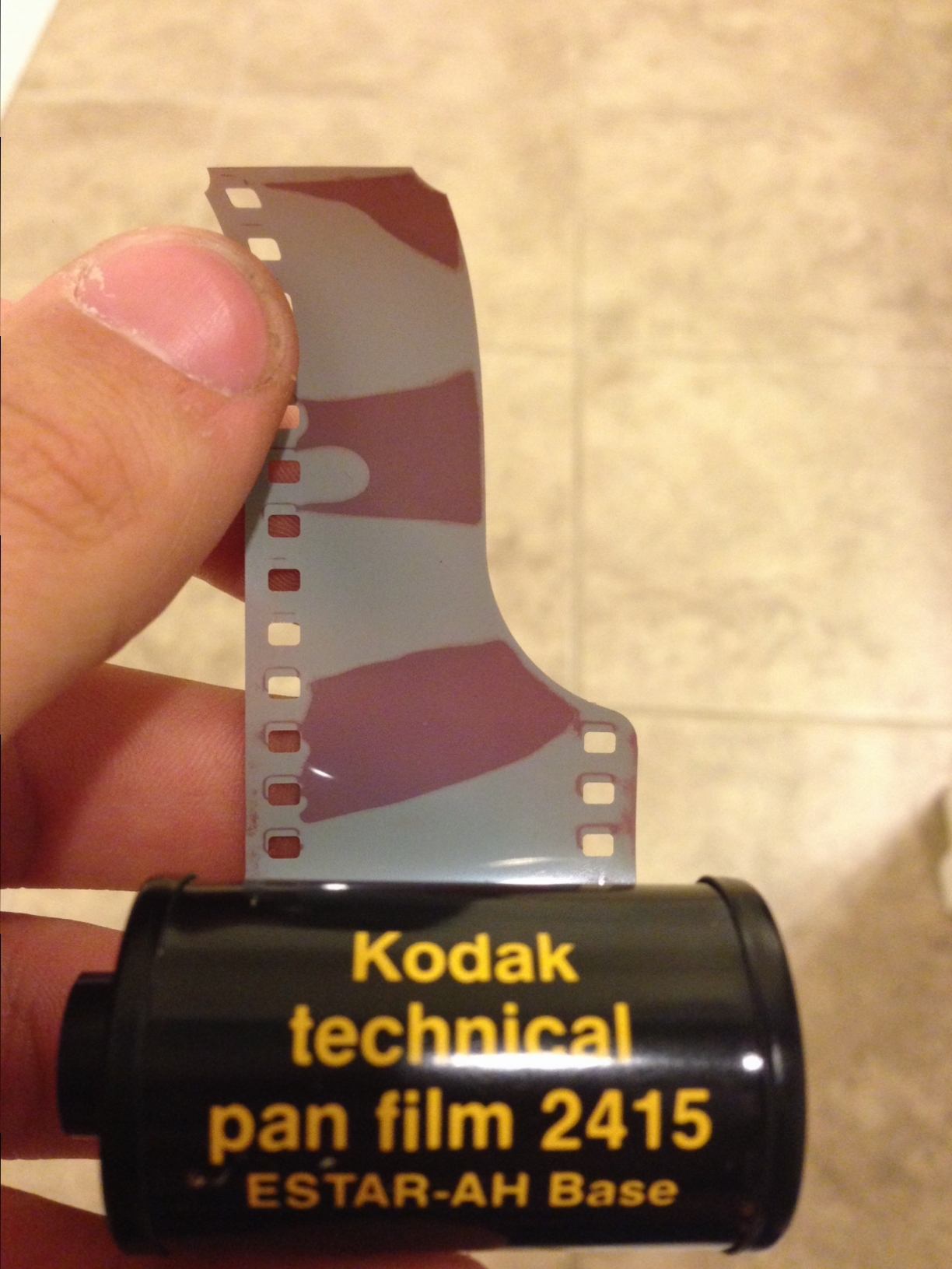

I just pulled the leader out of the cassette and I want to know if this is safe to shoot, Attending a graduation ceremony tomorrow and was hoping on trying this out...(The red banding on the emulsion matches the color of the film backing)

Kodak Technical Pan 2415 is awfully slow and finicky for a graduation ceremony.
What you have there is probably at least 20 years old as well.
It's a slow, fine-grained film that Kodak stopped making in 2004. Unless you know it's been stored properly (refrigerated or frozen), I wouldn't risk photographing an important event with it.
The discoloration of the leader might not mean anything, but pull a bit more out of the cassette to see if it continues up the roll.
Developing with a standard developer like D-76 will result in a lot of contrast. Unless that's the look you're going for, I would try a dilute developer like Rodinal 1:50 or 1:100.
This may sound like a crazy suggestion, but for an occasion as special as a graduation it might be prudent to use an in-date film so you know what to expect. I know that's crazy sounding, but...
I used quite a lot of Technical Pan back in the day. Great film, but not the easiest to use, and I'd definitely not attempt to use it for anything special, particularly as it's probably 15+ years outdated. (And not sure what the red banding is....looks very suspicious, so another reason to keep to a fresh general-purpose film for unrepeatable shots.)
Pull out a bit more from the canister. You may be lucky and it is just on the topmost part of the roll. Test a piece of the leader before using so that you get an idea of its state.
I thought I would "try out" some fresh Ilford Pan F+ for my sons' graduation party a few years ago. I processed it maybe two months after shooting it and was rewarded with a nearly clear filmstrip. If it's important, fresh film and film you know and trust.
^^^ Indeed! For events of such a high value, it would be wise not to risk with film of unknown state. We all learned it the hard way. :smile:
Processing Tech Pan to get a full grey scale of "normal" contrast is not easy, Delagi8 is useful but requires some dedication to the task.
I would never shoot it if I wanted a reliable result from a one off important occasion, "trying it out" is fine when it doesn't actually matter what the result is,I use it for fun.
A graduation is like a wedding where you carry a back up for the back up and double up on on every frame if you can, belt and braces and crossed fingers.

hi logan
i'm all for using expired film and developing it in some sort of home brew concoction .. but seeing it is a graduation cerimony
you probably want to memorialize on film and prints it would be tricky to expose your film ( probably 20 years old so that might be
like iso 6 in formulary technidol ? or if you want high contrast iso 50 in dektol // cut iso in half every 10 years ) not to mention the leader shows the film might
have started taking the dirt nap since it is weirdly discolored. if you have your heart set on expired film i'd go for some tri x or tmax400
or fuji superia200/400 ... or since it is something important maybe some fresh film ...
have fun at the graduation !

Thanks! I'll probably shoot a few frames and snip it for a test.

Nothing intrinsically wrong with Pan F+, but your experience again proves the importance of keeping to regular known films for any unrepeatable shoots. I can't understand the OP's insistence on using this untrustable film.....I'd bin it, or keep it to practice loading dev reels. :smile:

I stored some Kodak VR 200 color film in my crisper (at the bottom of the refrigerator). I had the same effect. The rolls were without canisters and, apparently, I dropped some liquid that seeped downward, then dried. It left its mark. Your film was involved with such moisture. - David Lyga
Yes David I had the same sugesstion - but I did'nt say it.
Because if we know for sure if this Kodak
Technical Pan is from the year 2002,2004 the expired date should be 2006,2008 (4years at a max.) and we expect the moisture damage should be only at the first beginning of the film - it would not impair the very first frame.
But it is hard to say, and the film should be much older so as others stated here.
If it is indeed an 10 Years expired emulsion with only smal moisture damage at the beginning Technical Pan would give acaptable results with ISO
12/12Din.
But there are much more doubts to give
a serius recommandation to do so:cry::cry:.
