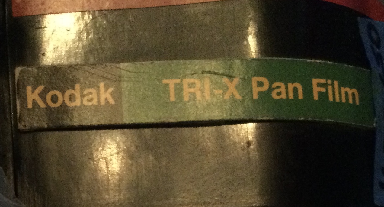

This is the label on my bulk loader, not sure if the use of the name Tri-X Pan film or the Kodak logo helps narrow down the date.
