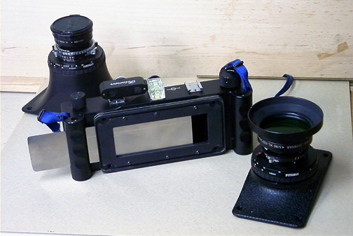

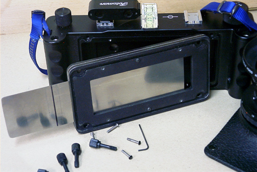

Swapping a lens on a Fotoman in mid-roll without wasting film is a hassle.
Working with a darkbag in hot sun or pouring rain is a pain.
So I made a darkslide module for my Fotoman 617...
Now I can change between my Schneider 80mm SS XL or my Fujinon 150 5.6 anytime I like.
Takes me about 30 seconds, out in bright sun or pouring rain.
No nasty words, no film wasted.
Ta Daaa....
Previously, I masked the camera for a 615 negative size, which I like better than 617.
(615 negatives can be enlarged on 4x5 enlargers).
See what I did in my TechBlog here...
http://www.classicbwphoto.com/Blog/E6DF1C66-A057-11DB-9BB1-000A95E8D0C0.html

Your darkslide module sounds like a GREAT improvement over the one major flaw of the Fotoman. I carry a darkbag and have never used it because of the major inconvenience so I end up using the whatever lens is on the camera for everything. Have you given any thought to marketing your module?

I know what you mean about working with whatever lens is on the camera instead of changing to one that is better suited to the subject. Changing a lens is (was) awkward. But no more...
I dunno about marketing the module...
I'd have to invest in a CNC mill, which is an attractive idea...
Decisions, decisions; more camera toys or more machine tool toys???
Decisions, decisions...
It was fun making it, nevertheless.
