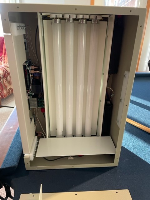

This is going to sound silly, but I've had good luck using an old Fotodyne DNA transfer lamp as a UV source for cyanotypes. It came with multiple germicidal fluorescent bulbs, which I've replaced with BLB. It even has a built-in timer!
There's one on eBay (not mine) for forty dollars, plus $40 shipping. You can see what it looks like here.
Just curious if anyone else has tried this?

I dunno, I will be worried about my DNA getting transferred....🙂
Can you give some more details - how big, how many lamps, etc. Does it have any ventilation?
:Niranjan.
Four bulbs, no forced ventilation, big enough to put my 8x10 contact printing frame inside.
That said, I just ordered a UV flashlight. 🙂
