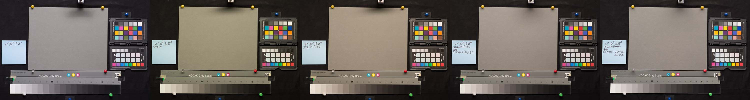

Thank you for sharing M. Carter! Recently I bought used, mint Photoflex strip dome HV and it's shows very strange green tint in resulting light flow. Tint comes from "white" lining inside. Had to add magenta CC gel to compensate for it. Im looking for replacement for it or to improve my sewing skills and to replace interior lining with Rosco Soft Silver foil.

Green tint come directly from the HV strip dome. I did test shots with regular Norman 10" reflector, Chimera medium soft box and Photoflex Strip dome and culprit was clear. Yellowing of front screen of the soft box can be nice, especially for portraits, but green tint is not nice except when you are lighting green screen. I'm not using CF bulbs or LEDs. I do like Kino flo bulbs, both tungsten and daylight in my Divas.

Hi M Carter, thank you for the interest in my issue with aging Photoflex strip soft box. In day or two I will have more spare time and will post sample pictures, before & after. There was definitelly no any green visible inside soft box, just in light output. Yes, weak magenta gel placed on inner baffle did cure it.

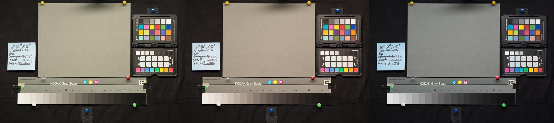

There are my test shots.
Norman 22" reflector, Photoflex Half Dome HV strip light, same with addition of 5x8" Rosco Cinegel 3314 (Tough ¼ Minusgreen) placed in the middle of inner baffle and two different size and different age Chimera soft boxes.
This Photoflex is covered inside with rubberized white coating and it looks that I will need to add ⅛ or ¼ CTB to correct for yellow tint too. There is no green visible anywhere? Most likely I will just make new silver lining for it or buy new one from your link.

Wow, that is certainly some green!!! Better call Captain Kirk!
